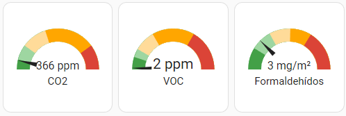

With Zigbee:
https://www.aliexpress.com/item/1005006751430082.html?spm=a2g0o.order_list.order_list_main.22.50a8586a4X9VRa
Just wondering how to get the remaining readings. I only see VOC in HA.
hi, how did you make to show the data from zigbee like that?
Add a “gauge” with sensor
