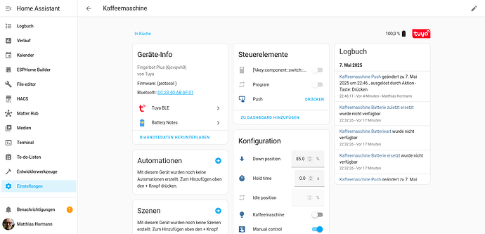

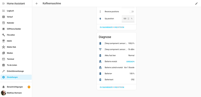

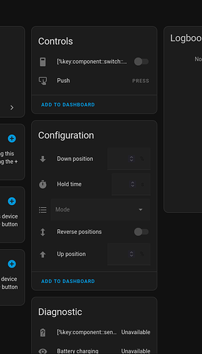

Since there are no issues enabled on your GitHub (please do), I would kindly ask you to add a new Fingerbot Plus device, under the "kg" type, with id 6jcvqwh0. I bought these from botland. These use a CR2 battery and have BLE (not Zigbee). I use them via the standard ESPHome Bluetooth Proxy. In the Tuya dev console, they’re shown as “手指机器人Plus(CR2, 蓝牙)”.

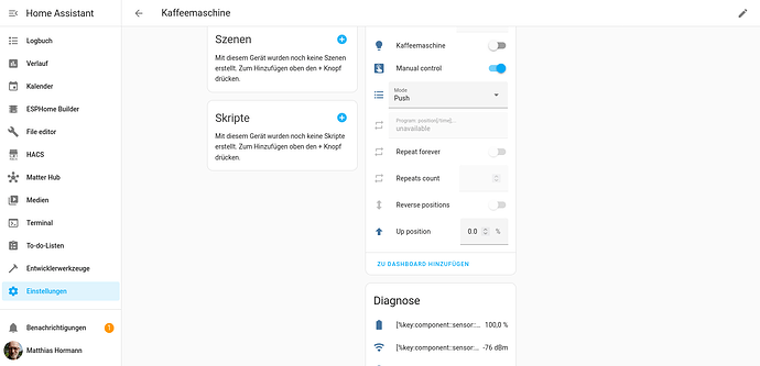

I had to manually patch 9 files I think, to add the id, and it works nicely. Hooray!There seem to be some undefined strings though, all shown as [%key:component::….
Would just love if you could add these (ids & strings). Here are some screenshots so you can see what I mean:
Thanks again, and hope to hear from you!
P.S.: Disregard the extra battery entries, they’re from the Battery Notes integration, so I can keep the Fingerbots in my battery inventory (and dashboard).

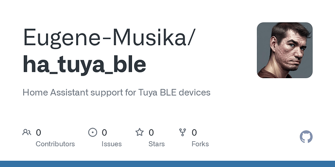

I’ve forked the Tuya BLE integration and added support for the Tuya BT smart lock (model: MQC2HEVY) — the one I bought from AliExpress:
https://www.aliexpress.com/item/1005006039862774.html
Just leaving this here in case someone else finds it useful. Feel free to check it out or reach out if you have questions!

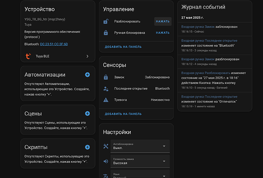

First, let’s check if your lock has the same set of dp_id’s. You can do this on Tuya Smart Developer Center => IoT Core => Device Control => Query Properties. If they’re different, you might need to change them.
Next, check if your lock is connected to your phone or hub. If it is, try disabling the Bluetooth on your phone and the Bluetooth on your hub.
I had a similar problem, and it was super confusing when it was solved by accident when I left my lock closer to a Bluetooth adapter. But mine was connected directly to an Odroid board with HA on it.
Also, your lock might not unlock with the current configuration because it expects to receive a specific value that can be different from mine. I used this data from Tuya IoT:
  «code»: «bluetooth_unlock»,
  «custom_name»: «»,
  «dp_id»: 6,
  «time»: 1747915289308,
  «type»: «raw»,
  «value»: «AQE=«
and the «AQE=« value
Your’s may be different.

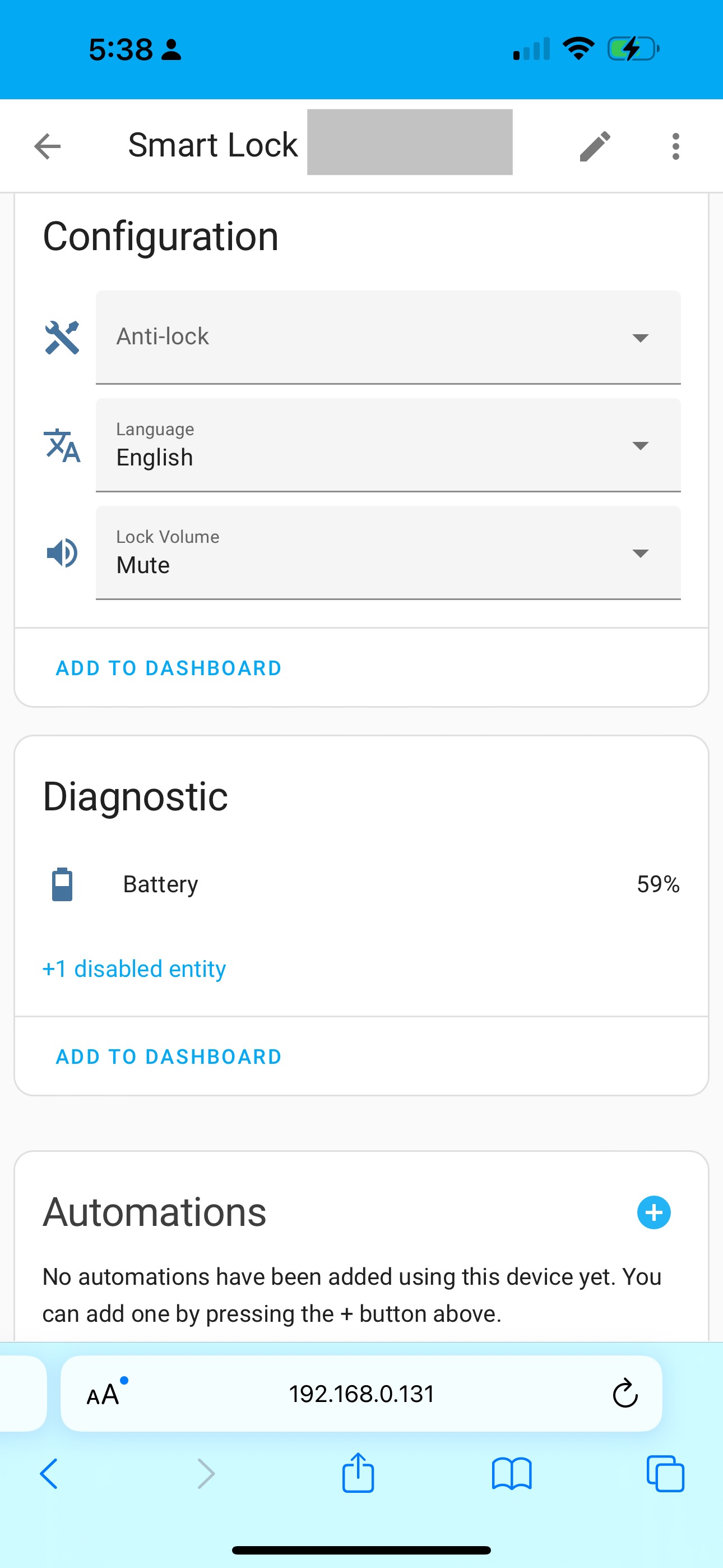

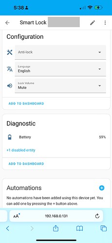

I’m able to add support for my lock by adding the product and category id for my lock. For quick testing I directly replaced the original category and product id in @Eugene-Musika codebase.
However, I see the following issues. I don’t think that all updates from the lock immediately are transmitted to my home assistant, for example when I tried unlocking by touch, it didn’t reflect immediately in home assistant. However it did appear later. I’m not sure if this is lost notification due to distance or a bug in the code. I don’t think it should be lost notifications because I reliably able to discover the lock at the initial setup of this integration so do not think there should be any lost ble messages but not sure.
Secondly the integration makes the home assistant timeout during the startup, seems it keeps waiting for lock updates to initialize the initial state of the lock at startup.
