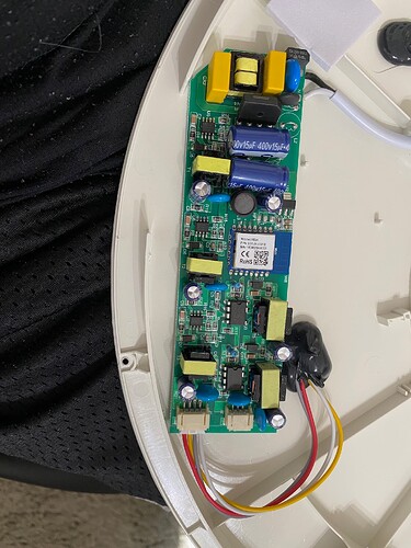

Hi, not sure if we are talking about same units. That said I will share following, hoping it is the one you are talking about or close. These have been working great for me with OpenBeken, very happy. I don’t remember for sure, but I do not think I was able to do the software only Tuya CloudCutter method (the first 2 I did with the physical flash, cause I did not fully grok CloudCutter at the time, I did a third and I think tried Cloudcutter, but had to do the physical flash, all that said, I now always try the CloudCutter route first. I have a dedicated Raspberry Pi for that purpose). All that blab… below are my basic notes and some pictures. I still have the firmware version from 2022 that I initially flashed them with running with Home Assistant, have not found need to upgrade. Though, that would probably be a good idea at some point… note my need for a stronger 3.3 volt power source for these units. I’m not sure if they are power hogs, or if the USB to TTL Serial adapter I was using was just punky. I’ve found it is a good idea to take photos of the disassembly steps, inside and connections. I’ve reinvented wheel too many times… And, for sure, make very sure the device has NO mains power connection while you are doing a physical flashing!

Had to power the circuit board with external 3.3 volt power supply, used one of the cheap bread board power supplies that output 3.3 volts, connection ground between breadboard power supply and usb usart, power to board was from bread board power supply, tx and rx from board was to uart usb device, used the sparkfun FDTI 3.3 v mini usb unit to greymini
the CEN reset did not work, just power cycling the breadboard 3.3 got it to connect to the usart usb
