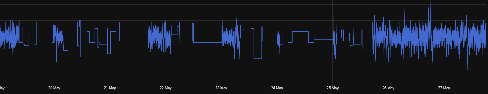

This has fixed my issue as it appears in the graph, before the update I used automation to reset the device once a day, but data errors hours or even minutes later, now after this change I have had no issues and the reset automation has been disabled since the update.
Nope, never mind, it appears to have not solved the whole issue. It might have prolonged the time it takes to stop reporting new data.
The changes I made and the use of framework 1.8.0 or newer fixed the checksum errors at least, as I have not seen any logging of checksum errors since.
But it appears that the Tuya MCU is stopping to report new data from some DP at random, but the rest is still reporting new data.
It’s like the MCU is waiting for an ACK-package or something for that specific DP, but the CB2S-module is not sending it or thinks it sent the package and is waiting for new data, catch 22, MCU wont send out new data until CB2S-module sends an ack, the CB2S-module will not send an ack until it gets new data from MCU…
For me it’s also different DP that stops reporting and it will get back to reporting at random too, why it starts reporting data again is a mystery.
