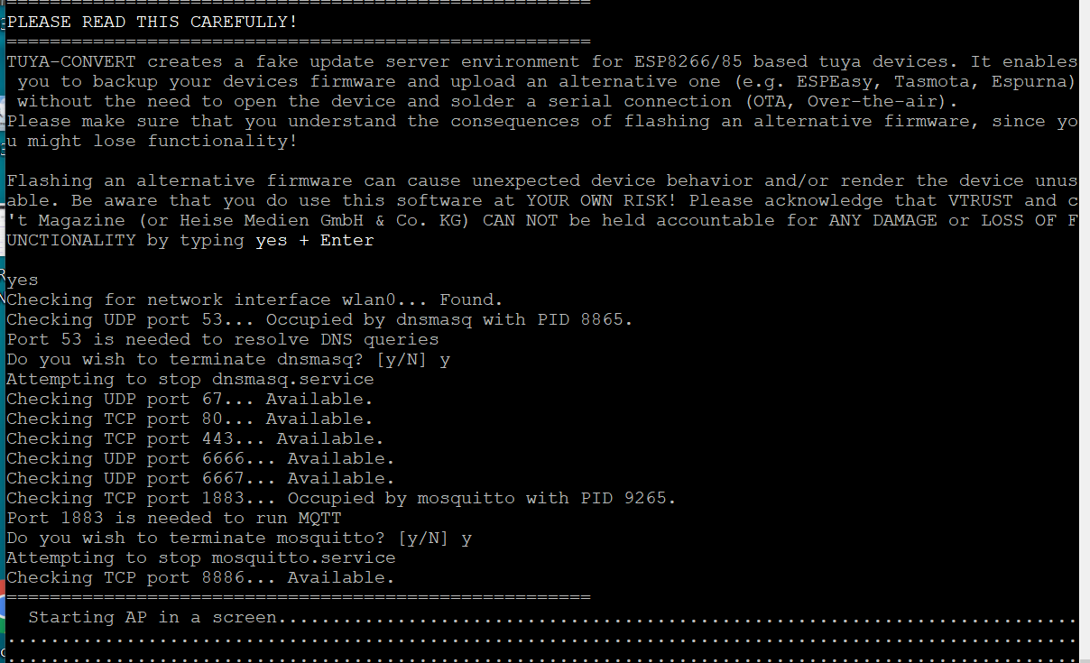

today, i boot up the same rpi3 so i can flash some more devices (same smart plugs bought at the same time but didnt flash until today) but rpi refuses to work. looks like the rpi tries to start up the AP but i dont see the " vtrust-flash" access point
command “./start_flash.sh”
error shows “screen: command not found”
i tried a different rpi3 but none worked.
please advise. thanks!

yes, i manually installed that screen later. vitrust SSD still no show.
i just tried on another rpi3. fresh install of the OS and everything but vitrust SSD refuses to come up.
Maybe a stupid question, but you are accessing your pi3 over ethernet and not wifi ?
yes, putty in via cat5
well, today, i got much further than before! i do see vtrust-flash SSID and used a phone to connect. it didnt ask for a pw to connect to that ap, weird.
but now i am stuck at “resending smartconfig packets” as seen here
