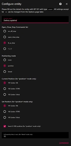

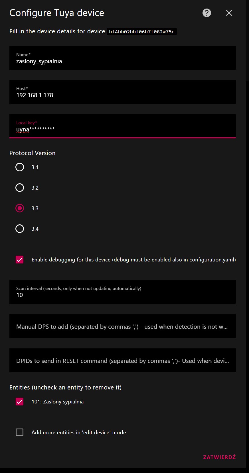

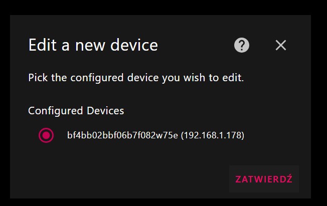

Also you can try my fix for buttions issue.
