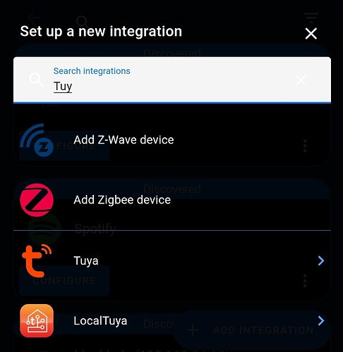

I would like to control the curtains of Abalon with HA.Curtain Link
In the official Tuya app they are available and can be controlled. Unfortunately, it looks different with HA. Here there is also Tuya and I can log in with my Tuya account but the curtains do not appear.
Has anyone here the curtains in use with Ha or an idea for me?
I have some experience with Tuya curtains and HA (I have 4 curtains and 2 shades). Are you trying to connect this through the regular tuya integration in HA or the local Tuya integration for HA? I have experience enough with the local tuya integration to where I can show you how to find the device in their API and then you can set up the device in HA but I have no experience with the regular tuya integration.
thank you for your answer. I had already installed the local Tuya but there I did not get further. How do I create it over the local one?
Watch/Follow this video: HOW TO - Setup Local Tuya in Home Assistant - YouTube When you get to the part about finding your devices in their API, let me know and I can walk you through the less standard parts:
