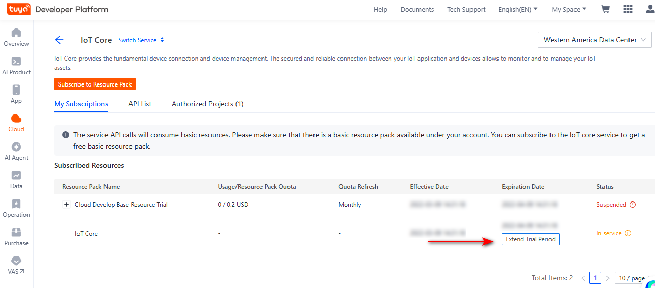

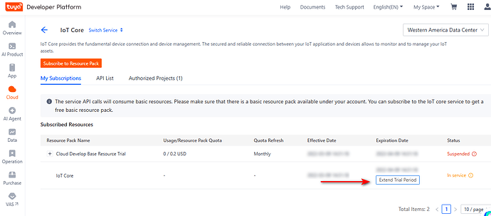

This will bring you to your cloud services page. from there, the first subcategory should be IoT Core, click on VIEW DETAILS:

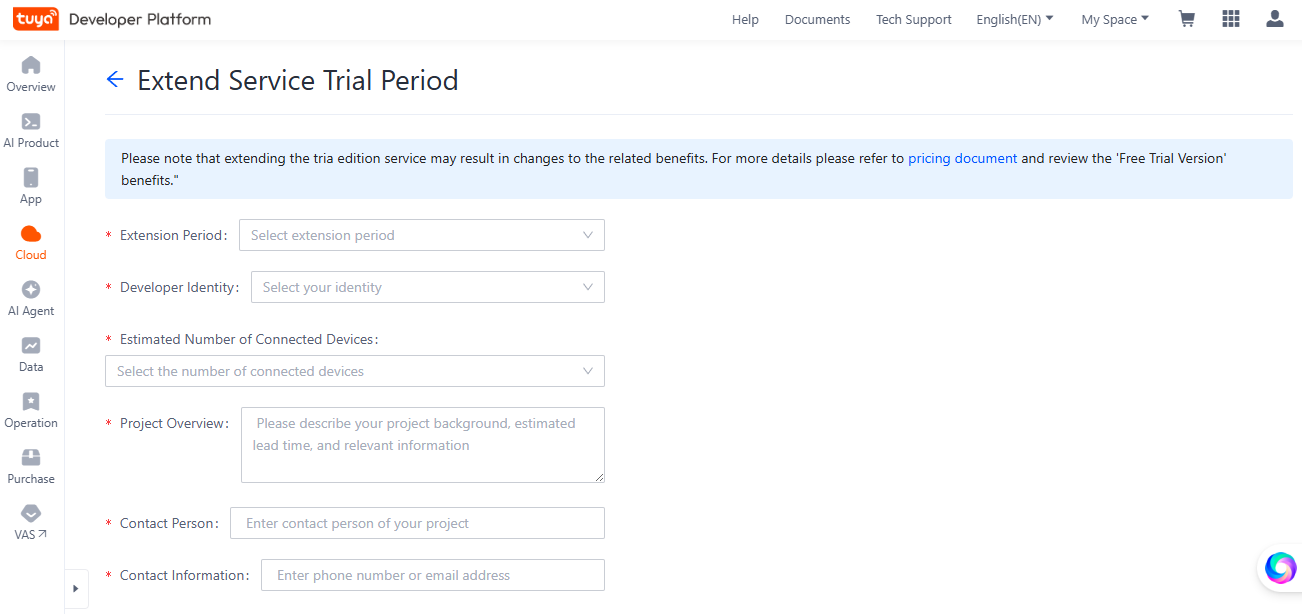

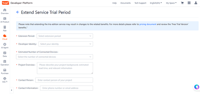

Finally, run through the application for a free trial. I am missing those screen shots as Ive written this after the fact. If someone can respond with pics of the process, ill put them in line.

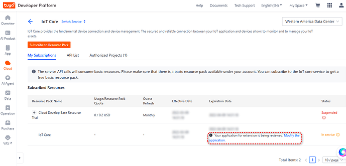

There WILL be a short wait while they “review” your application (it took about 10 minutes for me). You can check back to the IoT Core page to see when you’ve been processes and you should see “Your application for extension is approved”.

Thanks a million! Having all the steps as images is super helpful. Also, just a heads up, I tried this on my phone browser and the UI gets really messed up, and even when I somehow managed to get to the end, the bar to hit submit was not there, no matter what orientation, desktop mode, etc. Use a full sized computer to do this
At least the first pic of the free trial extension process… I forgot to take a screen-shot of the second one because I filled it out and clicked “ok”… :expressionless:
In case anyone else faces the issue where it says API error when renewing, you can change the data centre to China from Cloud → cloud services → dropdown box in top right corner. Changing it to china lets you extend at least for now.
Thanks. Here are the screenshots that you missed. (It’s going to take me three posts, since new members are only allowed to embed a single media per post.)
It took about 10 minutes for my extension to be approved.
