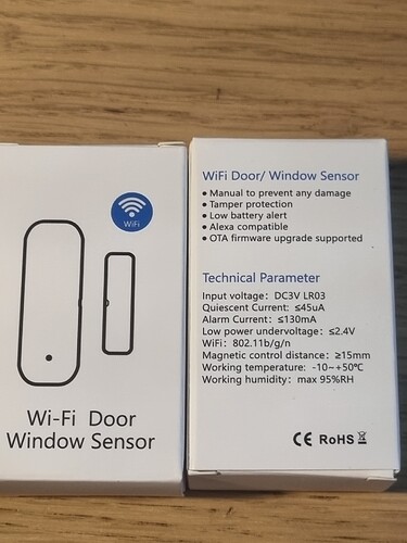

Tuya Door sensor configuration
I have converted this tuya door sensor to kickstart for use with Esphome. I can not find any configuration on the normal sites and ltchiptool can not find any due to not implemented yet.
Anyone that has the configuration before I start my tries to find it myself?
The sensor itself is D8 and it is LOW and connected and HIGH when door is open.
Battery level left to find out
