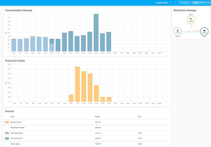

I have a Tuya energy meter PC311_TY (wifi) with the TUYA integration to get my solar production.
Eveything was working fine until end of 2023 and some patches, could not find the exact date. Before, I got a data from energy meter every hours and it integrate perfectly in the dashboard.
But now, the date don’t come any longer every hours, sometimes just once per day, or even once every week in Home Assistant.
