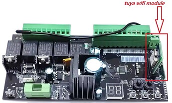

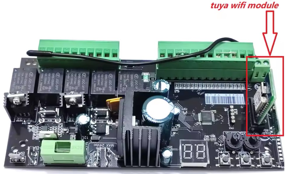

I’m also having a problem with my Tuya swing gate controller.
No entities are found in the Home Assistant Tuya integration.
Using Tuya Local (protocol version 3.5), incorrect device types are found.
Local Tuya doesn’t support protocol 3.5. The older protocols don’t work.
It works perfectly in the Tuya app.
My old ioBroker installation (with the Tuya adapter) also finds all entities without any problems.
How can I get this controller working in Home Assistant?
