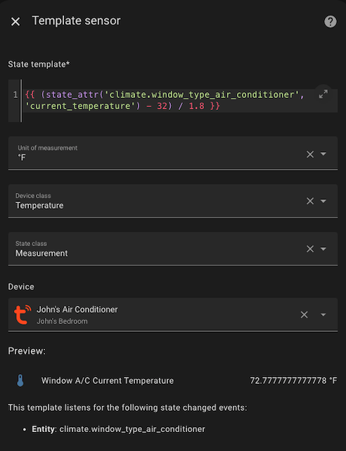

Create 3 helpers
  1. Template Sensor for reading temperature
    {{ (state_attr('climate.existing_heater, 'current_temperature')-32)*5/9 }}

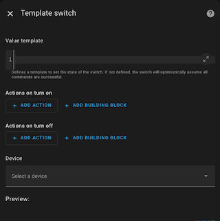

  2. Template Switch, leave it empty, this will be used to make the generic thermostat happy

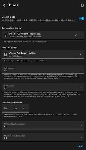

  3. Generic Thermostat, use the above two helpers when configuring
This should now get you a climate.custom_heater entity that can be used in a thermostat card.

Tried this, getting this error when setting up the initial Template sensor. Am I doing something wrong?

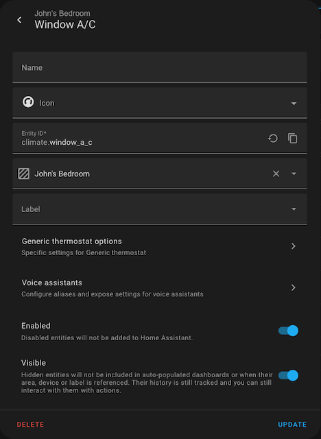

Here’s a working configuration for the Friedrich Uni-Fit A/C.
climate.window_type_air_conditioner is the original
climate.window_a_c is the custom

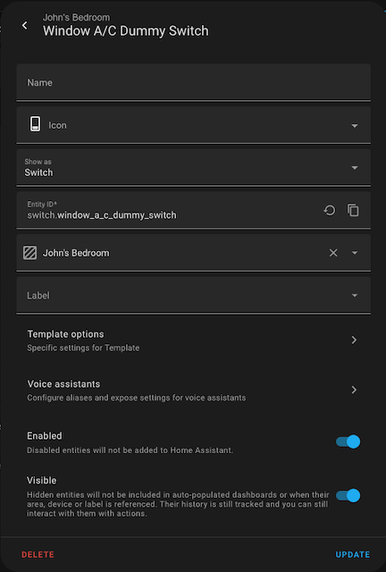

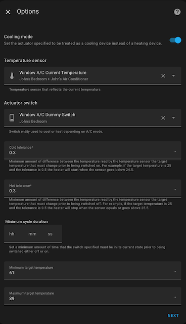

Helpers

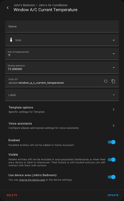

  1. Template Sensor
  1. Template Switch

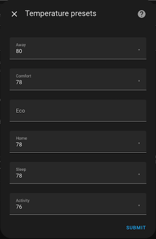

  1. Generic Thermostat
Automations
Similar to the example above, but I disable mirroring to the custom A/C while updating the original to prevent the automations from canceling each other out. I also added a small delay so the manual A/C buttons and Tuya app work well in conjunction with HA.
