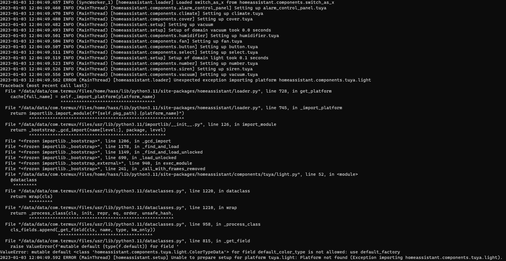

Sorry if this has been posted before, I have a few lights that i control using the Tuya Smart app and i did the tutorial to integrate with HA. However, every time i try to integrate, i get the devices but not the entities, which is weird:

Also, when loading Hass, i get the following error msgs regarding Tuya (don’t know if it is related but it says “unable to prepare setup for platform tuya.light: platform not found”)
Any ideas on what i could do?
