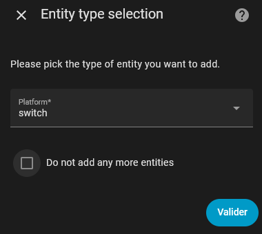

Hi, I’ve juste added a dual curtain switch on Tuya local and struggled a bit to find how to add both.
You add 1st switch, then when your paramters are fine, validate, and on next windows, just uncheck “Do not add any more entities” and validate.
A new windows will pop with a new entity to add (your 2nd switch).
Just check the box when you are done, and all entities will be add to your device
