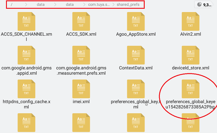

Now on the right, navigate to:
/data/data/com.tuya.smartlife/shared_prefs
shared_prefs
shared pref
You end up in a folder with some XML-files, this is where we want to go.
XML-files
shared pref1
Find the file called:
preferences_global_key_<some chars and numbers>.xml
and click it. ES File Explorer will open it (or better copy file and open in Notepad++). You will find the ID of your device’s!
