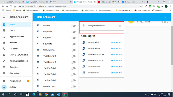

Hi @rospogrigio, hi @postlund.
In my Hassio I have 15 Tuya devices connected: switches, relays, dimmers; plugs and rgbplugs with Energy Meter. All devices are working fine. Now installed last master branch.
I also have an Energy Meter Switch.
It connected fine to Hassio, BUT I see it periodically becomes inactive in Hassioâs interface. At the same time, in the Tuya Smart app, it works fine.
There are no error entries in Hassioâs logs from this Energy Meter Switch.
Why can he become inactive?
Thanks.
