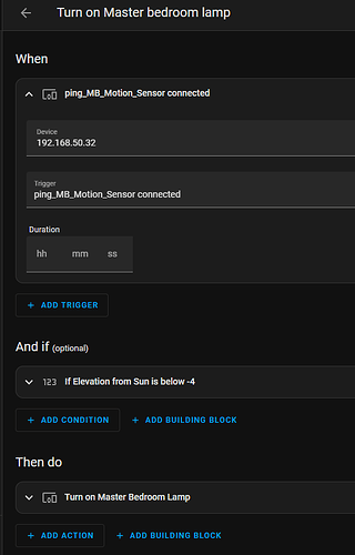

So I think its working, but it seems sporadic. Or maybe I’m missing the motion event not sure. Can someone help?
Using Ping (ICMP) integration to ping the motion sensor:
binary_sensor.192_168_50_32
Custom Polling of ping binary sensor:
Template Binary Sensor:
Automation (UI was easier to read than YAML code, due to entity IDs being so long):
Is there anything I’m doing wrong or is this sporadic behavior expected?
