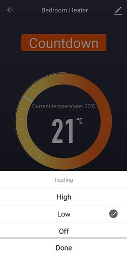

I successfully added my new Nedis WIFIFNH10CBK via Tuya integration and SmartLife app. If I do climate.turn_on for climate.bedroom_heater it starts the fan, but no heater. HA says it supports operation “heat” and “off”. But the app shows under Heating: High, Low and Off. Where Off has the fan active but no heater. And this is the mode that HA sets it in.
Can you start this device but in “High”-mode?

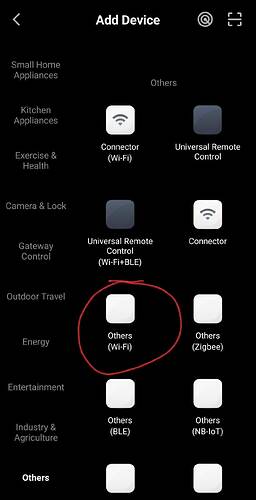

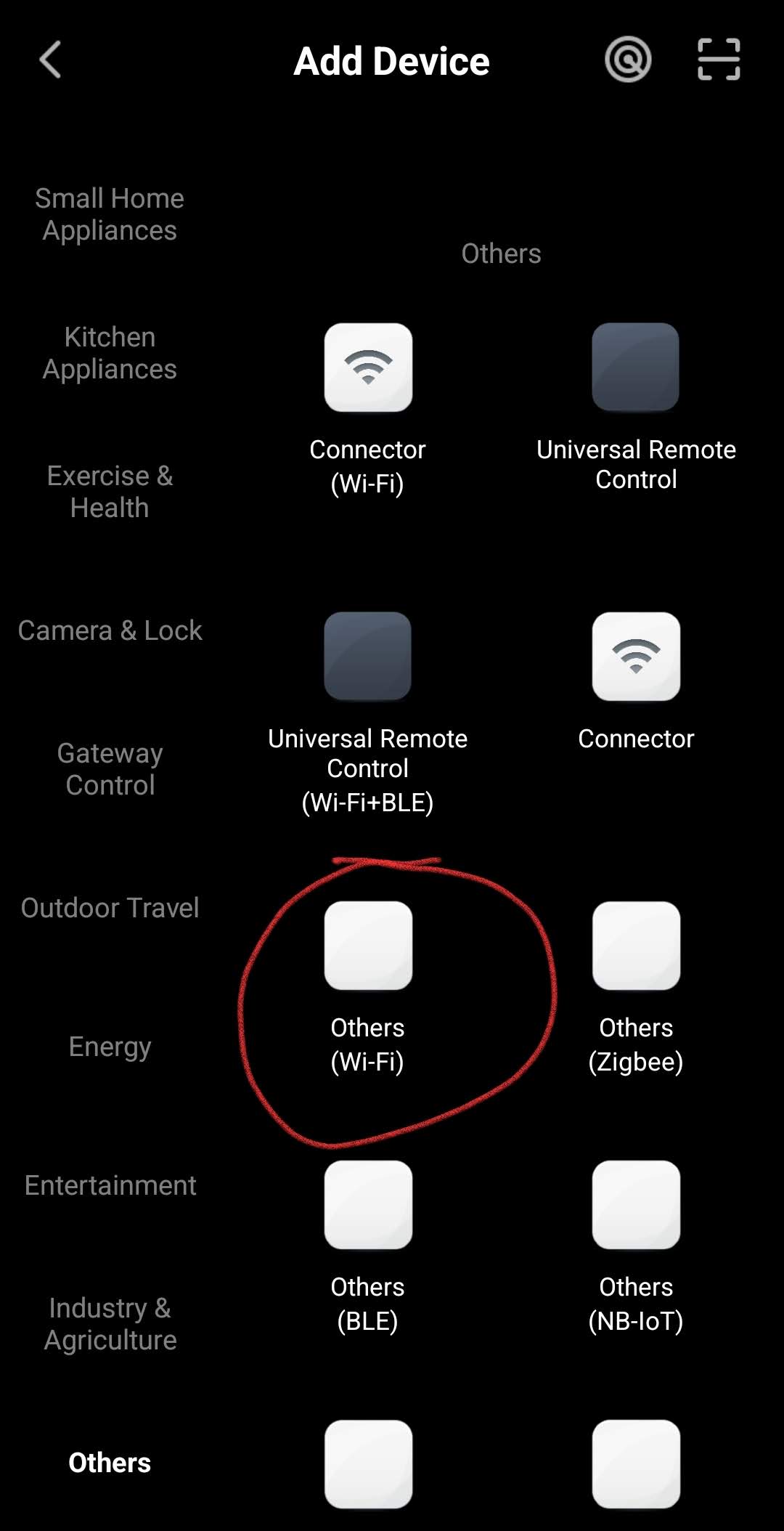

I made some changed to WiFi in the house and was forced to remove the heater from Tuya SmartLife. Something has changed in the app and I think this fan/heater doesn’t support EZ pairing (instead you need to do AP pairing). The fan is set to pairing by pressing POWER for 5 seconds.
In the SmartLife app (not Nedis), add device, manual, others and others (wifi). Then after selecting a 2,4GHz Wifi you connect to the fans AP and the installation continues.
