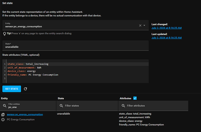

After adding the plug to Tuya (Using cloud integration) and adding an integral to monitor the consumption, the energy displayed is way off. What am I doing wrong here? Please ask question so I can provide correct information.
You could start by telling in what way the energy is “off” , i.e. to high , to low etc.
Also you have not told anything, so hard to tell if/where you did something wrong( if at all)
If you have some code/card, please post it “formatted correctly”
Format code in posts>
How to help us help you - or How to ask a good question.
also show your “Integral” , as you just shows pictures of entities, which ALL shows values, which are not unlikely, it’s impossible to guess what you mean
I have read more and tried different setups but I got lost. I got something working but it was something that was left over from an attempt that was not existing.
Here is where I am at now. I have the Tuya plug power sensor attached to a custom sensor but it does not seem to work as it should.
My guess is that I am not setting the state properly to update the statistics.

Here is an error I got in the logs. Also the tracking is not correct compared to the Tuya App
Logger: homeassistant.components.sensor.recorder
Source: components/sensor/recorder.py:302
integration: Sensor (documentation, issues)
First occurred: 10:50:10 AM (1 occurrences)
Last logged: 10:50:10 AM
Entity sensor.pc_energy_consumption from integration template has state class total_increasing, but its state is not strictly increasing. Triggered by state 0.21 (0.2237) with last_updated set to 2024-07-02T08:47:35.075646+00:00. Please create a bug report at https://github.com/home-assistant/core/issues?q=is%3Aopen+is%3Aissue+label%3A%22integration%3A+template%22
