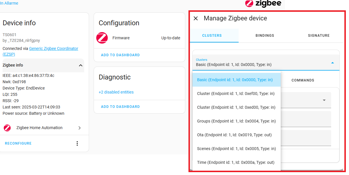

Hello, I’m using Home Assistant Core 2025.2.4, installed on Mini ITX with Sonoff ZBDongleGateway to handle Zigbee network.
Now I tried to add the Zigbee TS0601 da _TZE284_nlrfgpny Tuya Siren, but I have no entities to use it.
Here below the HA panel for this device:
There is a way to handle this device?
Many thanks for help!

In addition, I see that you device is " …TZE204_nlrfgpny not … ZE284_nlrfgpny as my
I see that “quirck” will be part of new release … but where can I find it?
Where is the folder?
