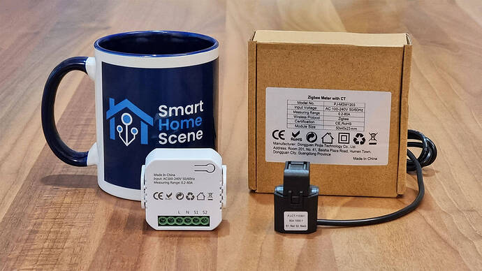

Tuya Smart Life ZigBee Energy Meter
Hi, I got Tuya Smart Life ZigBee Energy Meter connected in the HA using sonoff zigbee gateway usb3.0, but its only showing the diagnostic information of LQI and RSSI, no sensors information.
https://www.aliexpress.com/item/1005004948381800.html?spm=a2g0o.order_list.order_list_main.125.21ef1802R6LJrj
Anyone had the same issue, or know how can I retrieve the sensor information?
