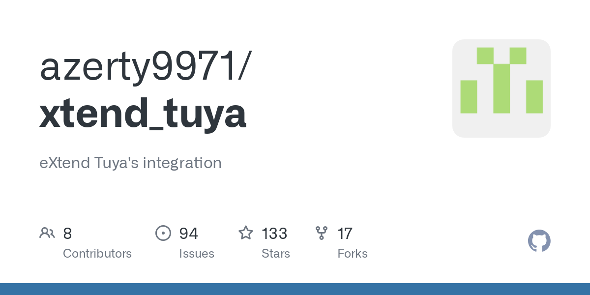

Thought this might be useful to those looking for an integration that supports locking / unlocking Tuya smart locks from within HA.
Stumbled upon this one which works with all of my smart locks.
In case you miss the instructions, here’s how to activate the functionality.

you can use the xtend tuya for the smart lock support
