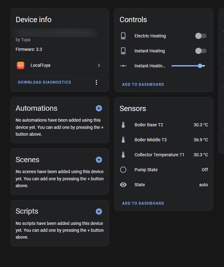

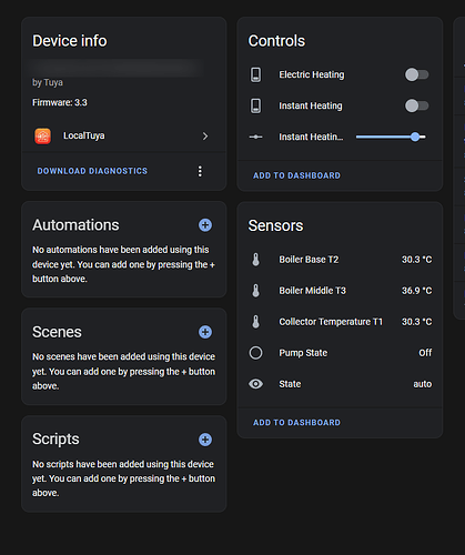

Fixed the problem by using Local Tuya where I was able to access the required data.
Hi neil-w,
I have the same issue with SR208C controller.
I added it using local tuya but i do not see all functions, can you share more details on how you integrated all functionalities.
Thx
I’m not using the pump option as it wasn’t compatible with my pump. In the end I kept my existing Solar controller and just added the two temperature probes supplied to my water tank so I can bring the two values in to HA.
Thx for the info.
For the moment i succeeded to integrate all available sensors of it even the setting for electric heating.
But i do not know for all parameters the usage or how the handle them :slight_smile:

Dear gents, after much digging around I came up with this. Maybe it will be of some help:

“friendly_name”: “SR208C”,
Result below. Some settings are boleans but I preffer just to see the state without being able to interact. Start forced heating, etc.
Or Like this for turning On/Off the heating element and adjusting the set temperature:

That looks fantastic! Ive finally managed to get Tuya-local to work, and I now have some entities from the SC208C, but the “tank temperature bottom” reading seems to be tied to the thermostat rather than being available as a separate entity. I don’t understand why, because the code in SR207.yaml definitely defines Tank temperature bottom (T2).
