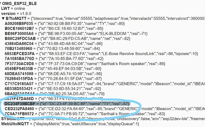

Hi, I’m very new to home assistant and have been trying to integrate a switch bot I got off Aliexpress (https://www.aliexpress.com/item/1005005240504102.html?spm=a2g0o.order_list.order_list_main.33.26fd1802uQqiMR) with the home assistant using openmqttgateway. I successfully set up a home assistant and connected the esp32 to the MQTT broker. I do see the Mac address of the switch bot but don’t really see the parameters to change like the state, etc. I see the mac address and am not really sure how to go from here any help would be really appreciated

Could you turn on showing Advertisement and advanced data to have the raw data shown as well in the MQTT messages?
This is also available as a Switch in the HA OpenMQTTGateway gateway Configuration.
With a Tuya device though, I am not sure if the state and changes will be shown in the freely available broadcast data, and might require a Tuya solution with connecting to the device, but we can have a look from some messages with the above turned on.
