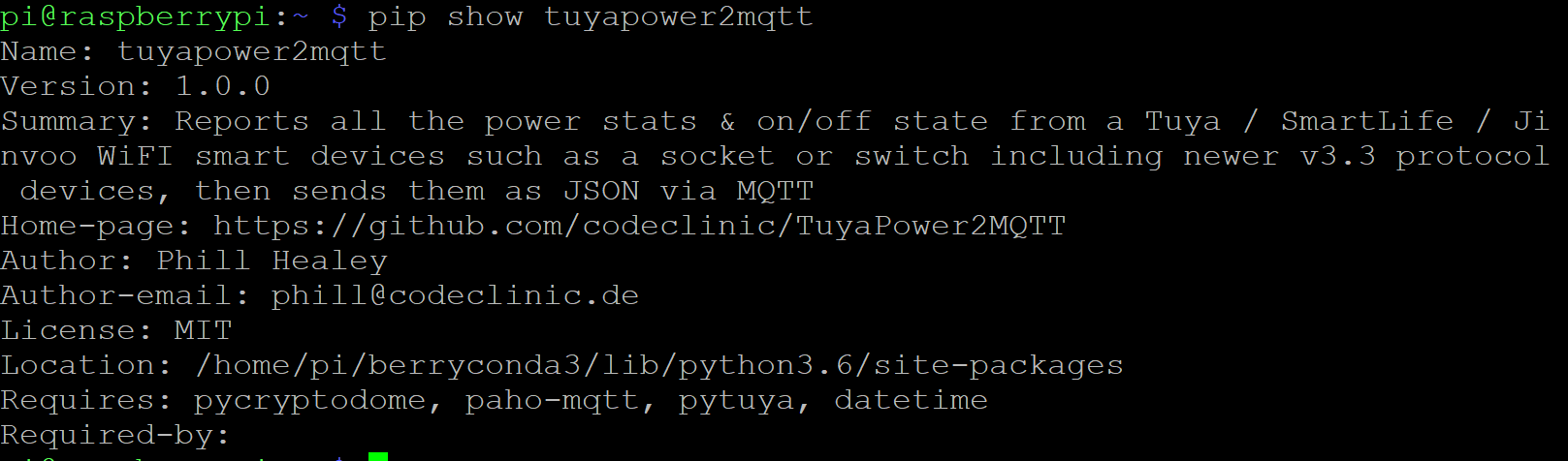

Now we need to find out exactly where pip installed the tuyapower2mqtt package.
pip show tuyapower2mqtt
You should see something similar to this:
Let’s edit the script to ensure that we can publish the stats to our MQTT server.
sudo nano /your/path/to/tuyapower2mqtt/getstats.py
