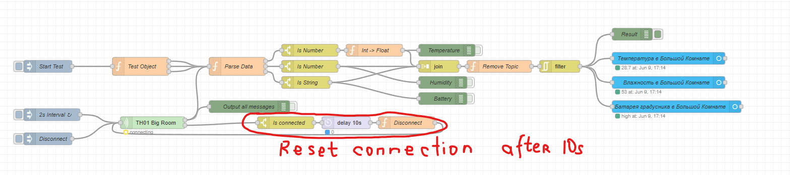

I’ve got THE solution.
A bit clunky but working fine.
For this you will need NodeRed and it must be connected to Home Assistant.
  1. Open NodeRed
  2. Open menu (top right)
  3. Manage palette
  4. Search and install “node-red-contrib-tuya-smart-device”
  5. Close palette
  6. Create new Flow
  7. Open menu (top right)
  8. Import
  9. Copy next code to a text region:
[{"id":"48a01b2342a9d9f8","type":"tuya-smart-device","z":"9fc5e5e4876edc36","deviceName":"TH01","disableAutoStart":true,"deviceId":"","deviceKey":"","storeAsCreds":false,"deviceIp":"","retryTimeout":1000,"findTimeout":"10000","tuyaVersion":"3.4","eventMode":"event-both","logLevel":"log-level-disable","x":860,"y":780,"wires":[["368a438fff2126ea","80169653855da865"],["0191b0e67a409968"]]},{"id":"368a438fff2126ea","type":"debug","z":"9fc5e5e4876edc36","name":"Output all messages","active":false,"tosidebar":true,"console":false,"tostatus":false,"complete":"true","targetType":"full","statusVal":"","statusType":"auto","x":1120,"y":740,"wires":[]},{"id":"80169653855da865","type":"function","z":"9fc5e5e4876edc36","name":"Parse Data","func":"return [\n    {\n        topic: \"TEMP\",\n        payload: msg?.payload?.data?.dps?.[\"27\"]\n    }, {\n        topic: \"HUMI\",\n        payload: msg?.payload?.data?.dps?.[\"46\"]\n    }, {\n        topic: \"BATT\",\n        payload: msg?.payload?.data?.dps?.[\"101\"]\n    }\n];","outputs":3,"noerr":0,"initialize":"","finalize":"","libs":[],"x":1090,"y":640,"wires":[["07b21dfdd6ddd0db"],["56f572541d1d9ab8"],["e2039573c1bdb1c9"]]},{"id":"07b21dfdd6ddd0db","type":"switch","z":"9fc5e5e4876edc36","name":"Is Number","property":"payload","propertyType":"msg","rules":[{"t":"istype","v":"number","vt":"number"}],"checkall":"true","repair":false,"outputs":1,"x":1270,"y":600,"wires":[["d88b0392d0dc89a4"]]},{"id":"56f572541d1d9ab8","type":"switch","z":"9fc5e5e4876edc36","name":"Is Number","property":"payload","propertyType":"msg","rules":[{"t":"istype","v":"number","vt":"number"}],"checkall":"true","repair":false,"outputs":1,"x":1270,"y":640,"wires":[["b117944bc2444b7f","a00d5a3fddb0fb6a"]]},{"id":"e2039573c1bdb1c9","type":"switch","z":"9fc5e5e4876edc36","name":"Is String","property":"payload","propertyType":"msg","rules":[{"t":"istype","v":"string","vt":"string"}],"checkall":"true","repair":false,"outputs":1,"x":1260,"y":680,"wires":[["036e714f2d2883b4","a00d5a3fddb0fb6a"]]},{"id":"d88b0392d0dc89a4","type":"function","z":"9fc5e5e4876edc36","name":"Int -> Float","func":"return { ...msg, payload: msg.payload / 10.0 };","outputs":1,"noerr":0,"initialize":"","finalize":"","libs":[],"x":1430,"y":600,"wires":[["799afcd70bb9ea0d","a00d5a3fddb0fb6a"]]},{"id":"1c14eaccbed47ccf","type":"inject","z":"9fc5e5e4876edc36","name":"Start Test","props":[{"p":"payload"},{"p":"topic","vt":"str"}],"repeat":"","crontab":"","once":false,"onceDelay":0.1,"topic":"","payload":"","payloadType":"date","x":620,"y":640,"wires":[["e4399d18794ce73e"]]},{"id":"e4399d18794ce73e","type":"function","z":"9fc5e5e4876edc36","name":"Test Object","func":"return [\n    { \"payload\": { \"data\": { \"dps\": { \"27\": 325 }, \"t\": 4 }, \"deviceId\": \"bf10c9082feef2247dkqig\", \"deviceName\": \"TH01 Big Room\" }, \"_msgid\": \"6af275ea3cfac2b2\" },\n    { \"payload\": { \"data\": { \"dps\": { \"46\": 57 }, \"t\": 4 }, \"deviceId\": \"bf10c9082feef2247dkqig\", \"deviceName\": \"TH01 Big Room\" }, \"_msgid\": \"7041aa09c4c5c188\" },\n    { \"payload\": { \"data\": { \"dps\": { \"101\": \"high\" }, \"t\": 4 }, \"deviceId\": \"bf10c9082feef2247dkqig\", \"deviceName\": \"TH01 Big Room\" }, \"_msgid\": \"82d2dfa7a540b9cd\" }\n];","outputs":3,"noerr":0,"initialize":"","finalize":"","libs":[],"x":850,"y":640,"wires":[["80169653855da865"],["80169653855da865"],["80169653855da865"]]},{"id":"799afcd70bb9ea0d","type":"debug","z":"9fc5e5e4876edc36","name":"Temperature","active":false,"tosidebar":true,"console":false,"tostatus":false,"complete":"payload","targetType":"msg","statusVal":"","statusType":"auto","x":1610,"y":600,"wires":[]},{"id":"b117944bc2444b7f","type":"debug","z":"9fc5e5e4876edc36","name":"Humidity","active":false,"tosidebar":true,"console":false,"tostatus":false,"complete":"payload","targetType":"msg","statusVal":"","statusType":"auto","x":1600,"y":680,"wires":[]},{"id":"036e714f2d2883b4","type":"debug","z":"9fc5e5e4876edc36","name":"Battery","active":false,"tosidebar":true,"console":false,"tostatus":false,"complete":"payload","targetType":"msg","statusVal":"","statusType":"auto","x":1600,"y":720,"wires":[]},{"id":"c4a7ab0a4af8ca37","type":"inject","z":"9fc5e5e4876edc36","name":"2s Interval","props":[{"p":"payload"}],"repeat":"2","crontab":"","once":false,"onceDelay":0.1,"topic":"","payload":"{\"operation\":\"CONTROL\",\"action\":\"CONNECT\"}","payloadType":"json","x":630,"y":760,"wires":[["48a01b2342a9d9f8"]]},{"id":"a00d5a3fddb0fb6a","type":"join","z":"9fc5e5e4876edc36","name":"","mode":"custom","build":"object","property":"payload","propertyType":"msg","key":"topic","joiner":"\\n","joinerType":"str","accumulate":true,"timeout":"","count":"3","reduceRight":false,"reduceExp":"","reduceInit":"","reduceInitType":"","reduceFixup":"","x":1590,"y":640,"wires":[["25cf65706d1e1fdf"]]},{"id":"88f1367fd989cbd9","type":"debug","z":"9fc5e5e4876edc36","name":"Result","active":true,"tosidebar":true,"console":false,"tostatus":false,"complete":"payload","targetType":"msg","statusVal":"","statusType":"auto","x":2070,"y":560,"wires":[]},{"id":"3570656d7cbd637c","type":"rbe","z":"9fc5e5e4876edc36","name":"","func":"rbe","gap":"","start":"","inout":"out","septopics":false,"property":"payload","topi":"topic","x":1890,"y":640,"wires":[["88f1367fd989cbd9","120ad92108706d98","dfaa49812aba30bb","a0602dda08b5cdaa"]]},{"id":"25cf65706d1e1fdf","type":"function","z":"9fc5e5e4876edc36","name":"Remove Topic","func":"return {\n    ...msg,\n    topic: undefined\n};","outputs":1,"noerr":0,"initialize":"","finalize":"","libs":[],"x":1740,"y":640,"wires":[["3570656d7cbd637c"]]},{"id":"2bced59cc42ffb21","type":"delay","z":"9fc5e5e4876edc36","name":"","pauseType":"delay","timeout":"10","timeoutUnits":"seconds","rate":"1","nbRateUnits":"1","rateUnits":"second","randomFirst":"1","randomLast":"5","randomUnits":"seconds","drop":false,"allowrate":false,"outputs":1,"x":1360,"y":780,"wires":[["ce2880dd057bdf95"]]},{"id":"ce2880dd057bdf95","type":"function","z":"9fc5e5e4876edc36","name":"Disconnect","func":"return { payload: { \"operation\": \"CONTROL\", \"action\": \"DISCONNECT\" } };","outputs":1,"noerr":0,"initialize":"","finalize":"","libs":[],"x":1510,"y":780,"wires":[["48a01b2342a9d9f8"]]},{"id":"9dd1ee9da6cec31b","type":"inject","z":"9fc5e5e4876edc36","name":"Disconnect","props":[{"p":"payload"}],"repeat":"","crontab":"","once":false,"onceDelay":0.1,"topic":"","payload":"{\"operation\":\"CONTROL\",\"action\":\"DISCONNECT\"}","payloadType":"json","x":620,"y":820,"wires":[["48a01b2342a9d9f8"]]},{"id":"0191b0e67a409968","type":"switch","z":"9fc5e5e4876edc36","name":"Is connected","property":"payload.state","propertyType":"msg","rules":[{"t":"eq","v":"CONNECTED","vt":"str"}],"checkall":"false","repair":false,"outputs":1,"x":1210,"y":780,"wires":[["2bced59cc42ffb21"]]},{"id":"120ad92108706d98","type":"ha-entity","z":"9fc5e5e4876edc36","name":"Temperature","server":"8485343b883bf6bc","version":2,"debugenabled":false,"outputs":1,"entityType":"sensor","config":[{"property":"name","value":"Temperature"},{"property":"device_class","value":"temperature"},{"property":"icon","value":""},{"property":"unit_of_measurement","value":"C"},{"property":"state_class","value":""},{"property":"last_reset","value":""}],"state":"payload.TEMP","stateType":"msg","attributes":[],"resend":true,"outputLocation":"payload","outputLocationType":"none","inputOverride":"allow","outputOnStateChange":false,"outputPayload":"","outputPayloadType":"str","x":2120,"y":620,"wires":[[]]},{"id":"dfaa49812aba30bb","type":"ha-entity","z":"9fc5e5e4876edc36","name":"Humidity","server":"8485343b883bf6bc","version":2,"debugenabled":false,"outputs":1,"entityType":"sensor","config":[{"property":"name","value":"Humidity"},{"property":"device_class","value":"humidity"},{"property":"icon","value":""},{"property":"unit_of_measurement","value":"%"},{"property":"state_class","value":""},{"property":"last_reset","value":""}],"state":"payload.HUMI","stateType":"msg","attributes":[],"resend":true,"outputLocation":"payload","outputLocationType":"none","inputOverride":"allow","outputOnStateChange":false,"outputPayload":"","outputPayloadType":"str","x":2120,"y":680,"wires":[[]]},{"id":"a0602dda08b5cdaa","type":"ha-entity","z":"9fc5e5e4876edc36","name":"Battery","server":"8485343b883bf6bc","version":2,"debugenabled":false,"outputs":1,"entityType":"sensor","config":[{"property":"name","value":"Battery"},{"property":"device_class","value":"enum"},{"property":"icon","value":""},{"property":"unit_of_measurement","value":""},{"property":"state_class","value":""},{"property":"last_reset","value":""}],"state":"payload.BATT","stateType":"msg","attributes":[],"resend":true,"outputLocation":"payload","outputLocationType":"none","inputOverride":"allow","outputOnStateChange":false,"outputPayload":"","outputPayloadType":"str","x":2140,"y":740,"wires":[[]]},{"id":"8485343b883bf6bc","type":"server","name":"Home Assistant","version":2,"addon":false,"rejectUnauthorizedCerts":true,"ha_boolean":"y|yes|true|on|home|open","connectionDelay":true,"cacheJson":true,"heartbeat":false,"heartbeatInterval":"30"}]
  1. Change device id, device ip, device key in tuya node (light green node on the left bottom of screenshot)
  2. Change name for temperature entity (both fields, first blue node on right)
  3. Change name for humidity entity (both fields, second blue node on right)
  4. Change name for battery entity (both fields, third blue node on right)
If you have problems you can increase/decrease delay for connection reset.

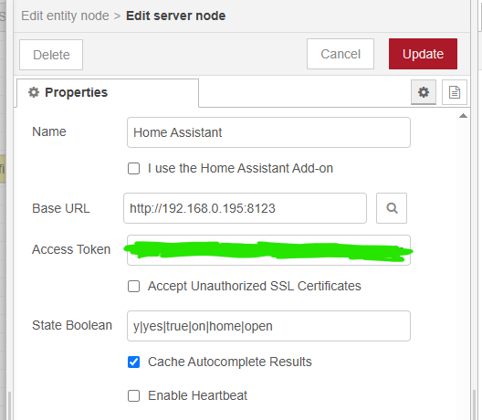

  1. Are you sure that you can’t see new entities in Developer Tools of Home Assistant?
  2. If entities are not seen in dev tools then check that your Access Token is valid (HA → Profile → Security → Long-lived access tokens).
Here how my connection settings looks:
Thanks, the error message deappears and I see the sensors in Node-red companion !
