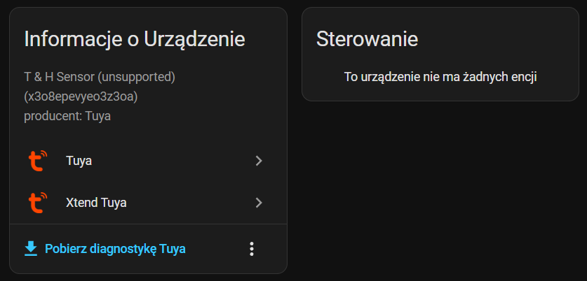

Tuya T & H Sensor (unsupported)

happening exactly the same to me, one of my sensor broke so i got a new one, identical to the ones i had before. Old ones are working fine but the new one is loaded as “unsupported”. Sensor is working fine as i can see the details in Tuya app !!

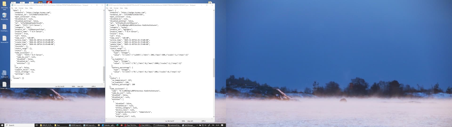

The issue can be seen here: two T&H sensors from a same box. The on the right works also in HA but the one on the left doesn’t, as it’s ‘status_range’ and ‘status’ fields are empty. Since the Tuya cloud registers the devices on the server side, there’s nothing we can do. GitHub has a ticket with more info on specific addreses to fix if doing Tuya Local or LocalTuya… The device with PID x3o8epevyeo3z3oa seems to be a newer device and probably already dominant in web shops. This is getting more and more people pissed on Tuya and hence changing into Sonoff etc devices…
I’m far from an expert here, but from what I can tell, the base of the problem is that the device is incorrectly registered as as power socket (tdq) when it is clearly a T&H sensor (wsdcg). Ideally, changing that would make things “just work”, but as I don’t have that power I’ve made this ugly workaround which appears to be good enough for my purposes.
