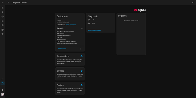

I recently got this tuya water valve from Ali, but it does not seem to be supported correctly by Homeassistant/ZHA. It does pair without problems, but the device does not bring any entity up.

You can post new device support request(s) to ZHA Device Handlers under issues in GitHub repository:
Zigbee devices that do not only use standard configuration and parameters (default ZCL clusters and attributes) but instead also implement custom manufacturer clusters and attributes (also known as “quirks”) will need a custom handler/converter/parser/translator as Python script code in the upstream “ZHA Device Handlers” library repository to extend custom manufacturer device “quirk” support for specific non-standard ZCL clusters and attributes (which Zigbee gateway implementations that depends on zigpy and the ZHA Device Handlers library, like Home Assistant s ZHA integration, then can make use of).
https://github.com/zigpy/zha-device-handlers/#readme
If you can not code that Python script code yourself to write the needed custom handler/converter/parser/translator for adding that specific device to the “ZHA Device Handlers” repository/library then suggest submitting a “device support request” (with device signature and diagnostic information) as new issues → https://github.com/zigpy/zha-device-handlers/issues
Without a “device support request” as a new issue posted to the “ZHA Device Handlers” repository/library requesting support for an unsupported device or device feature with Device signature and Diagnostic information the ZHA integration developers will not even know about the device unless they by random chance happened to have bought it themselves.
The reason is why non-standard devices need a custom handler/converter/translator is explained in ZHA integration documentation here → https://www.home-assistant.io/integrations/zha#zha-exception-and-deviation-handling
Zigbee devices that use clusters and attributes that are standard in the official ZCL (Zigbee Cluster Library) do not need custom handlers/converters/translators as explained in the ZHA integration documentation here → https://www.home-assistant.io/integrations/zha#knowing-which-devices-are-supported
