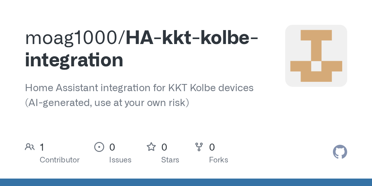

Hi, I did something with claude code (AI!). But I also added an explanation for local integration as a how-to for those that don’t trust AI code :slight_smile: . If you want to contribute and of course TEST it, please let me know. Instructions are in my Github. I’d love to add more KKT Kolbe devices. I “tried” to add the HERMES (not sure about difference to HERMES & STYLE I have, so feel free to test).
