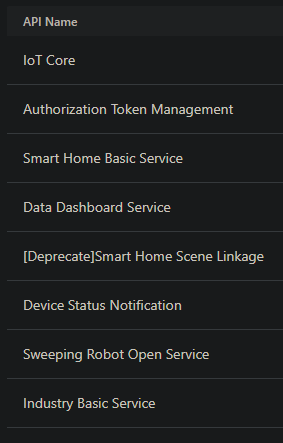

Service API:

Hello. The API for managing robot vacuum cleaners is not present in the “standard” list. To make it all work you need to go here:
At this point, in the “Authorized Projects” tab click on the “Add Authorization” button and connect the project created previously. At this point in the “My Subscriptions” tab you will find the new API called “Sweeping Robot Open Service” and you can finally configure the integration in HA.
Did that, same nonetype error. Prior to adding “Sweeping Robot” I just got the first error. After adding I got the 2nd error instead. My Tuya API logs show success on their end.
Error occurred while validating: Request failed, unknown error: {'code': 28841101, 'msg': 'No permissions. This API is not subscribed.', 'success': False, 't': REDACTED, 'tid': 'REDACTED'}

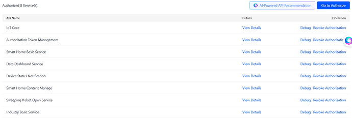

I have ensured that the “Sweeping Robot Open Service” API has been authorized:
Any assistance is appreciated.
