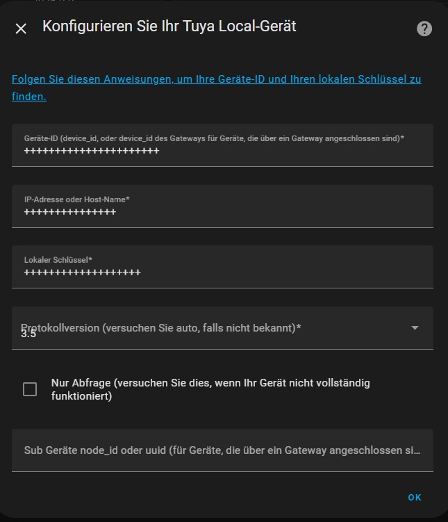

However, I switched to TuyaLocal (and not Local Tuya that does not support Tuya 3.5 - used by this defice) as adviced here:
Hi @all show this video
this is perfekt fit GitHub - make-all/tuya-local: Local support for Tuya devices in Home Assistant
and is run on 3.5

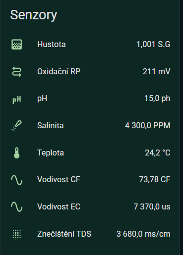

and I integrated it successfully into HA via the “Xtend Tuya” integration. From the start I also saw only thermometer, but soon realized that other sensors are just not allowed and it was quite easy to allow them via the user interface setting in Xtend Tuya Device settings…
So now I see all entities (I don’t use the alarm Hi/Lo warnings, so I allowed only sensors and not the alarm values…)
All 8 values fully readable in HA, also in UI settings can be changed the name/unit and icon to reach proper output in HA cards. as below:
(sensors are not calibrated yet, so they show nonsense values yet…)
Maybe it helps?
