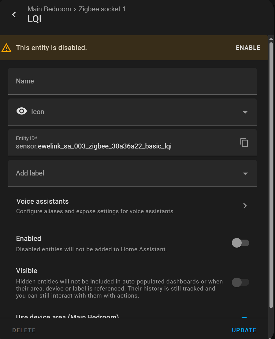

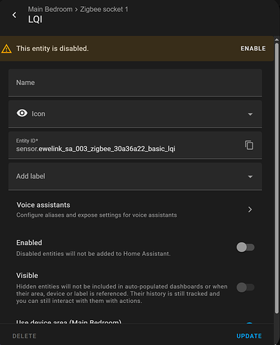

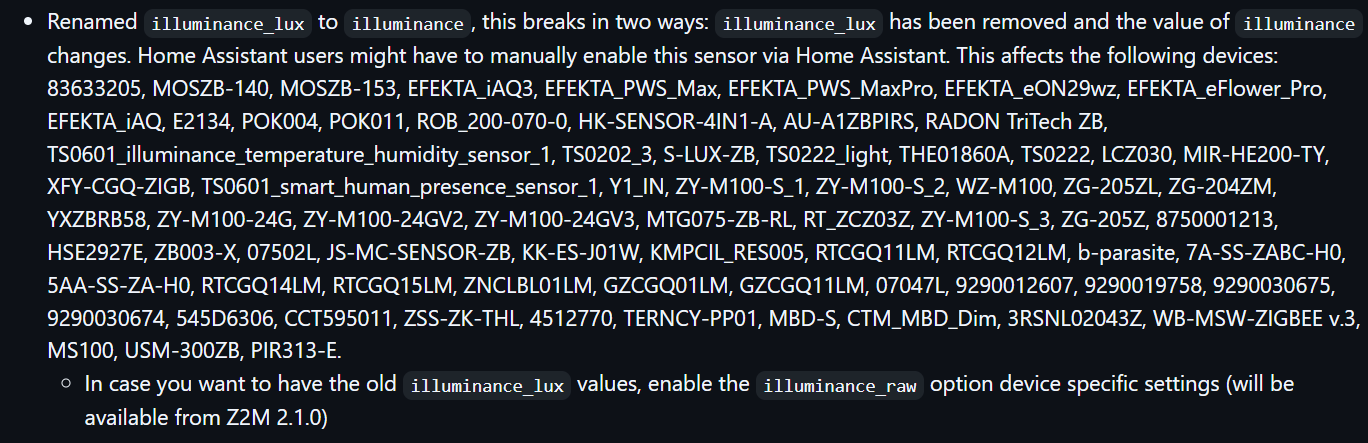

That was caused by one of the Z2M 2.0 breaking changes:
All you need to do is click on the disabled entity in HA, click the settings (cog) icon in the top right and enable it from the options. Don’t forget to press updated at the bottom when you’re done
PS - remove your manual MQTT config. You don’t need it.
