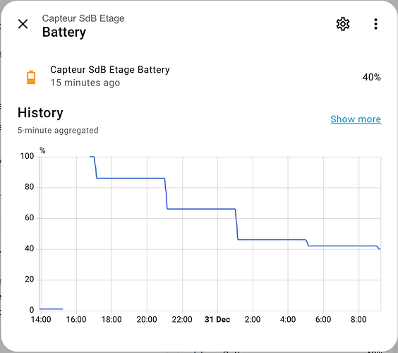

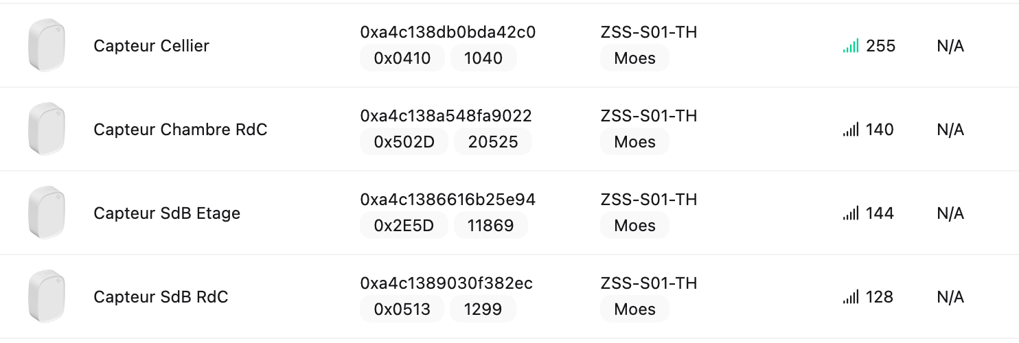

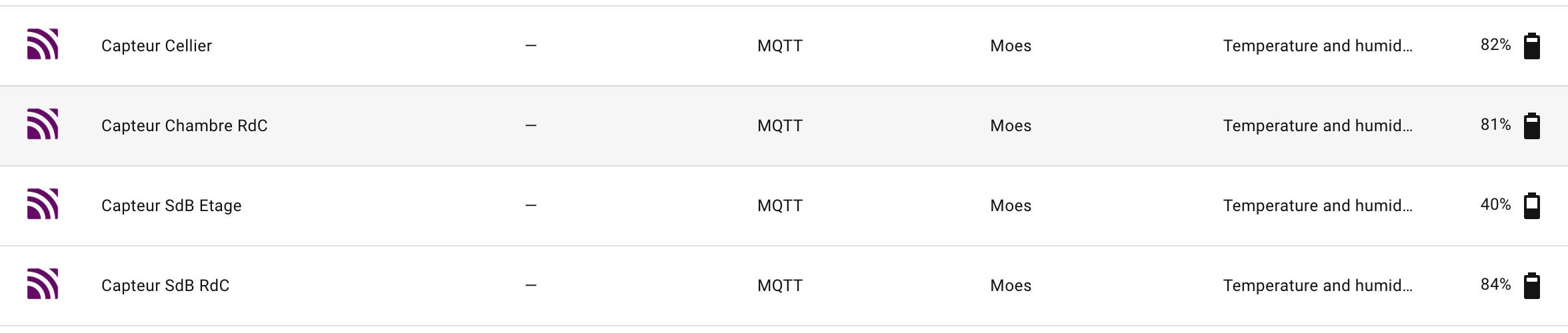

I have deployed 4 of these in my house and I have the same issue for 1 of them: it drains battery in a matter of hours. For example, I’ve put a brand new one yesterday around 5:00pm and it has only 40% left:
