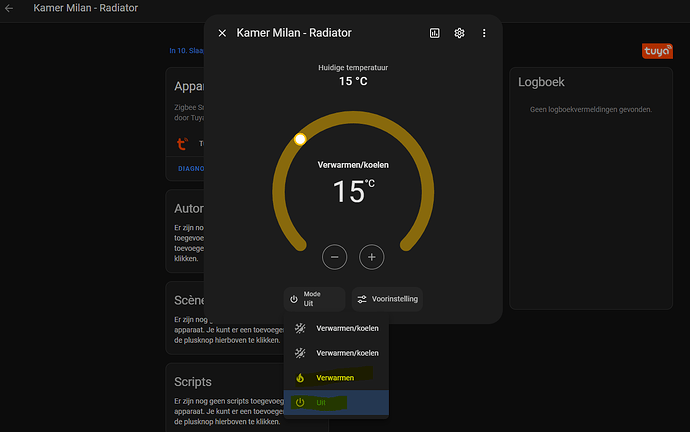

When using the card, I can only successfully turn the thermostat to the ‘Heat_cool’ setting:
When other modes are enabled, such as ‘Heat’ or ‘Off’, an error occurs: “The climate/set_hvac_mode service could not be called. network error:(2008) command or value not support”:

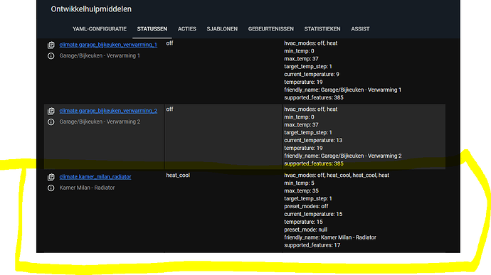

And why does “hvac_mode” has two “heat_cool” modes?
These are the settings in my Development tools:
