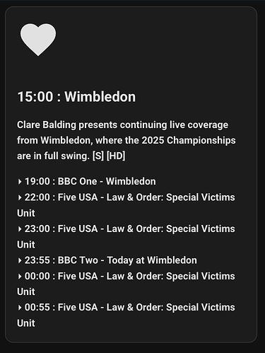

Love this. Thank you. Here is my contribution: a card showing when your favourite shows are on.
type: markdown
content: |
  {# Define your favourite keywords. #}
  {% set favs = [
  'Bikers',
  'Weakest',
  'DIY'
  {# Define your EPG sensors. #}
  {# See https://community.home-assistant.io/t/tv-guide-uk/749693 #}
  {% set channels = [
  "epg_bbcone",
  'epg_bbctwo',
  'epg_bbcthree',
  'epg_bbcfour',
  'epg_radiosportsextra',
  'epg_radiofivelive',
  'epg_itvone',
  'epg_itvtwo',
  'epg_itvthree',
  'epg_itvfour',
  'epg_cfour',
  'epg_morefour',
  'epg_five',
  'epg_fiveusa',
  'epg_quest'] %}
  <div style="text-align:center"> <ha-icon icon="mdi:heart"> </div></br>
  {% set matches = namespace(progs=[]) %}
  {% for channel in channels %}
    {% set evts = state_attr("sensor."+channel,'event') or [] %}
    {% for e in evts -%}
      {%- set st = as_local(as_datetime(e.startTime)) -%}
      {%- set en = st + timedelta(minutes=(e.duration | int(0))) -%}
      {%- if en > now() -%}
        {% for fav in favs -%}
          {% if fav.lower() in e.name.lower() %}
            {% set prog = [{'channel': channel, 'time': e.startTime, 'name': e.name}] %}
            {% set matches.progs = matches.progs + prog %}
          {% endif %}
        {% endfor %}
      {% endif %}
    {% endfor %}
  {% endfor %}
  {# Sort programmes in time order.#}
  {% set sorted_items = matches.progs|sort(attribute='time') %}
  {% for item in sorted_items %}
    {%- set st = as_local(as_datetime(item.time)) -%}
    {{ st.strftime("%H:%M") }} : {{ item.channel }} - {{ item.name }}
  {% endfor %}
card_mod:
  style:
      ha-card {
        --mdc-icon-size: 60px;
EDITED 11/10/2025: Due to move from freesat to freely API

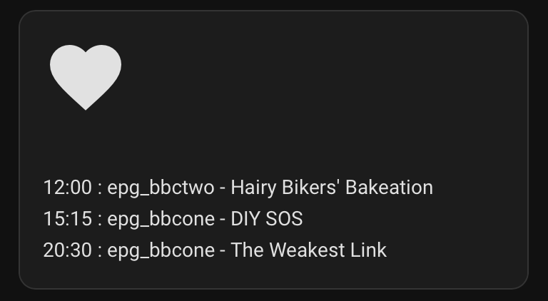

Here’s how my card showing my favourite shows looks:
Edited 11/10/2025 due to move from freesat to freely API. Now uses the sensor name as the channel name.
