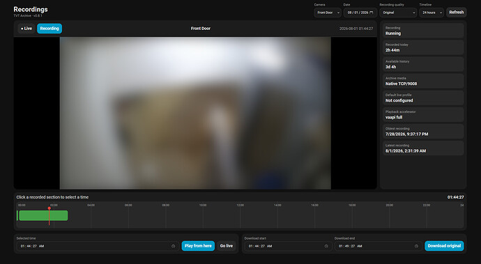

TVT Archive adds a Recordings panel to Home Assistant where you can browse the camera’s SD-card archive, move through a timeline, play recordings with audio, and export clips.
Features
  • Browse recordings stored directly on the camera or recorder
  • Calendar + 24 / 12 / 6-hour timelines
  • Playback with pause, rewind and seeking
  • Recorded audio
  • Original, 720p and 480p playback qualities
  • MP4 export
  • Multiple cameras
  • Hardware-accelerated transcoding where available
