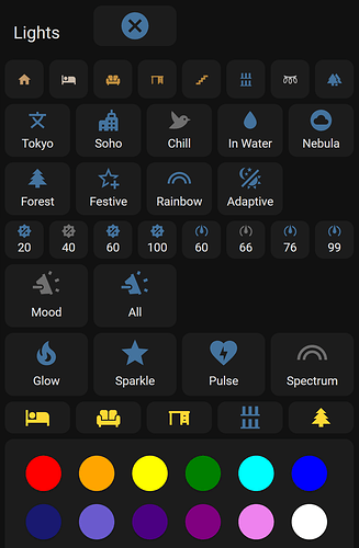

The xled_plus project wasn’t created with Home Assistant in mind, so there’s no simple direct communication between the two. My solution was to use shell commands and python scripts to facilitate calling the xled_plus functions from outside of Home Assistant. For simply controlling on/off and brightness, I used the native Home Assistant Twinkly integration.
