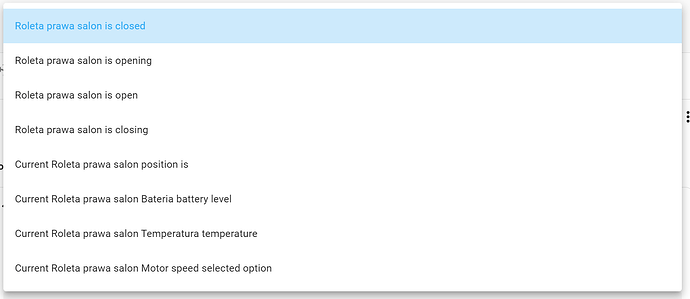

But when I’d like create an automation I have different condition lists! For example missing “Running it on” or charging status.
For the left device I see:
For the right device I have:
Why it’s happened and most important how to align both? Now have toruble build automation for right device (where is less items in drop-down list) according my idea.
