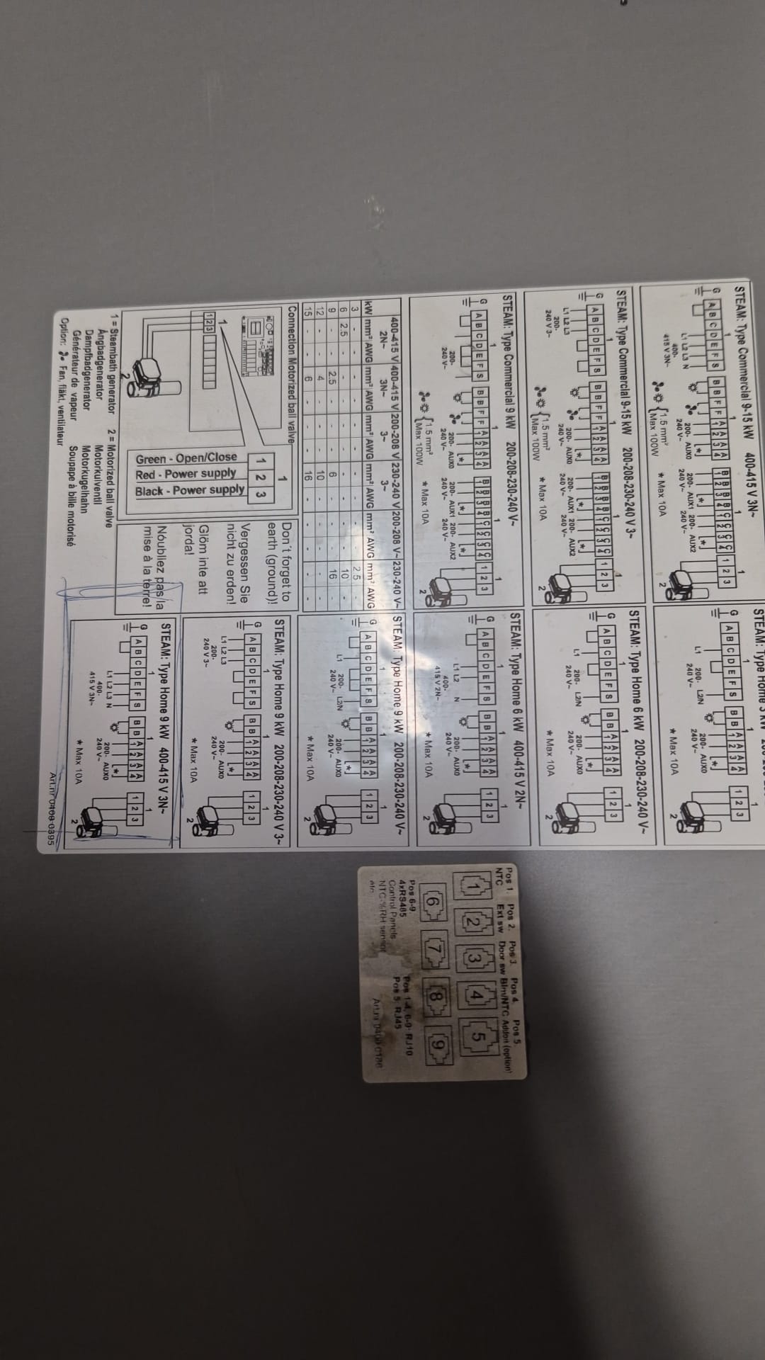

Hi, that’s an amazing piece of work. I have at home a Tylo sense of 8Kw coupled with a steam generator from Tylo controled by a Tylo Elite Cloud Control Panel Wi-Fi. Such sauna are called tylarium. I see that your code mainly focus on getting the dry sauna under control and was wondering if anyone has ever tried to also control the steam as it seems that the Tylo controler has put some protection to avoid a dangerous situation where sauna would be set at 95c and steam at 80% (way too hot and even risk of burn). Let me know if I can help to get this project to control the steam too
Fred
Yesterday I have tried to connect it. Unfortunately without any result.
  • The hardware seems ok. 12V comes in, converts to 5V and the rs485–>ttl gets 3.3V as it should.
  • The TX and RX are connected to 41 and 42 but always remain at 3.3V.
  • The A and B signal sits at 0.150V and doesn’t seem to move.
  • No RX and/or TX light on the level converter.
    I will try to connect a USB to RS485 since it appears the sauna isn’t transmitting anything. I will let you know.

This looks like an OLEA-103 controller board (DIP-switch setting?). Timings should be similar to Combi / Elite / Combi Elite.
Your RS-485 interface must see the bus traffic between the original panel and the steam generator, if you don’t see that traffic (LEDs), the wiring is incorrect.
