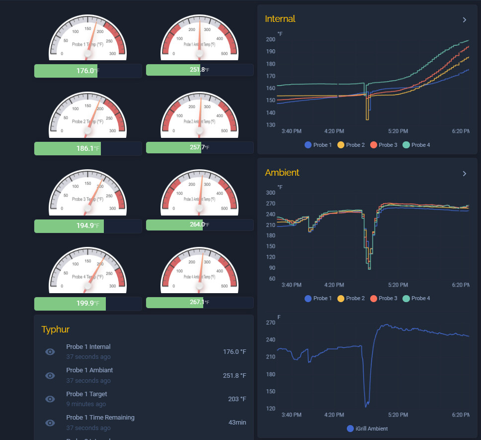

I just got a Typhur Sync Gold Quad to get around no integration in HA, I’m using the Typhur Android app, Tasker and MQTT to pull data from my phone and get it into HA.

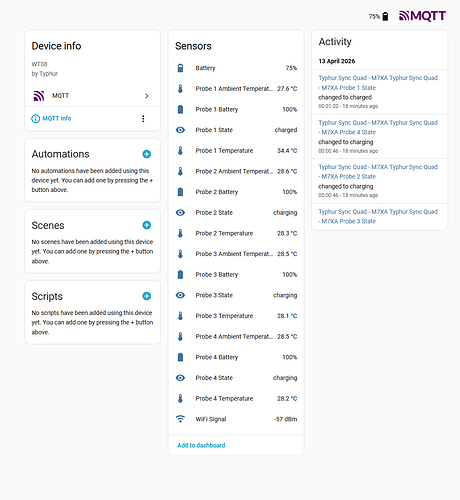

Hi, ended up vibecoding a addon that works.
Its cloud only,
Here is the link typhurHA/typhur_bridge at main · oleost/typhurHA · GitHub
