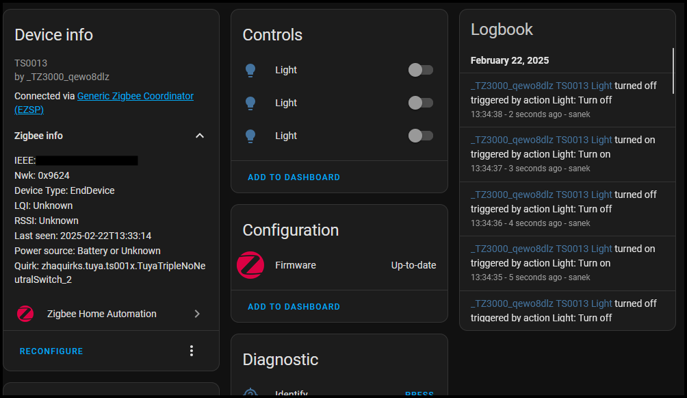

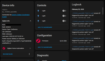

Mine working fine, but as an End device, unfortunately.

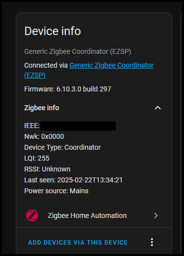

I use “SONOFF Zigbee 3.0 USB Dongle”
