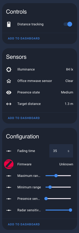

@Bruners Thanks for creating this - I’ve been using it, seems to grab all the settings correctly, it’s not detecting prescence consistently - attached is the current settings
Illuminance seems to work, the target distance is updating, the detect stays on clear.
Just checking there wasn’t something in the configuration I have set incorrectly?
Thanks again for the work on this.

Not fully sure what the presence status actually shows, im getting different results somewhat random.
Presence sensitivity is set to 1 in your photo, i have mine and radar at 6-7
