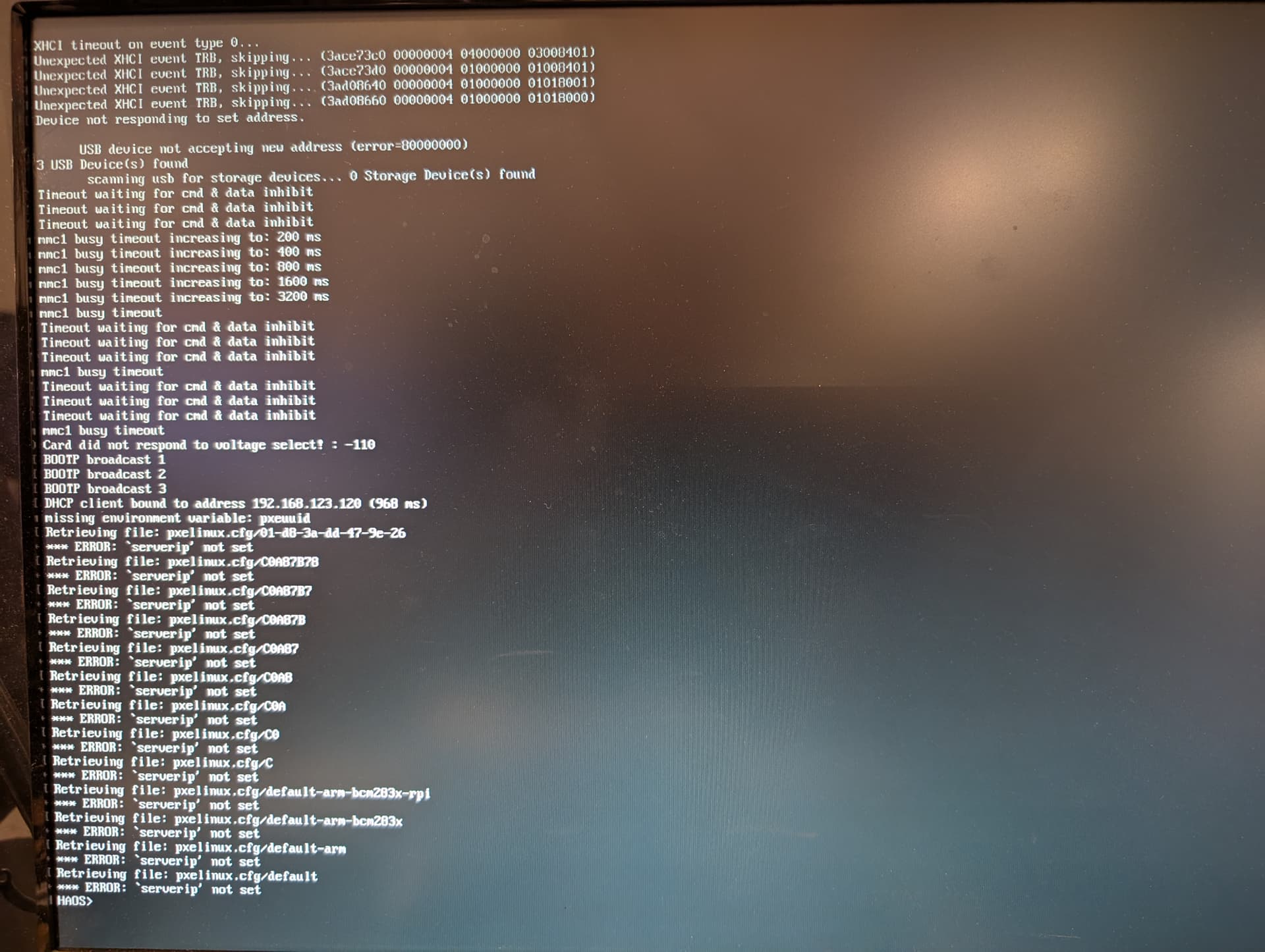

I have a RPI4 8GB with the official power supply. It’s been running HA fine for a couple of years, with HAOS on a USB-connected SSD (a 1TB Samsung T7.)
A couple of nights back, we had some power surges in the house, and now the RPI4 won’t boot anymore. It repeatedly loops in U-Boot with this message “Card did not respond to voltage select! : -110”, see screenshot.
Is my RPI4 fried? Or the SSD corrupt? Or what? All advice, suggestions welcomed.

Well, I was able to fix this myself.
  1. I used the Raspberry Pi Disk Imager to create an SD HA image and found the RPi4 could boot OK from that. So the RPi4 didn’t appear to be fried.
  2. I used Windows Services for Linux to take a copy of the last automatic HA backup from the data partition of the USB-attached SSD drive.
  3. I used the Raspberry Pi Disk Imager again, this time to re-install a fresh HA image on the USB-attached SSD drive. The RPi4 was then happy to boot from that, and I could restore the last automatic backup, that I had rescued in the previous step. The HA is now working fine again.
