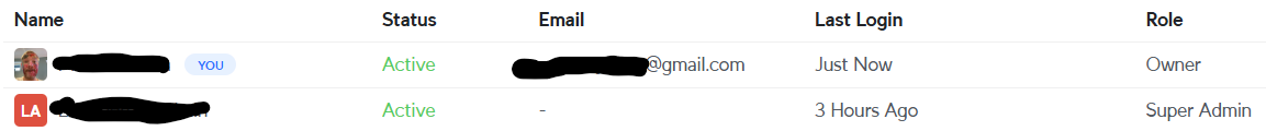

Where is the email address stored? I need to change it - I’m running out of time before I cant access the email its send the MFA to.
What are you actually trying to do? The local user account which you need to use the integration does not require an e-mail address.
I clicked around now and if you need to change your owner e-mail address (this has nothing to do with your integration) you can do that here https://account.ui.com/
This… @jazzmonger You need to do that work on UI.com
The HA integration ONLY uses a local account and local access to the UniFi devices your email address is in your account on unifi

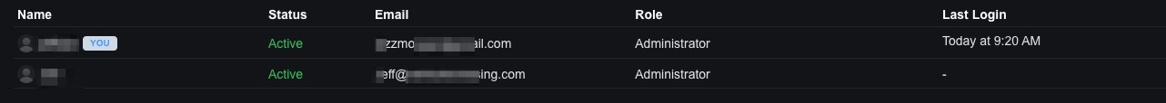

I totally get that. But somehow the email address listed on the admin page of the unifiy app in HA is NOT the email address the MFA is sent to when I log in. I’ve changed/deleted the admin user in both the HA app and on the UI.com site to no avail…
I have NO idea where it’s grabbing this email address. Its not in HA:

That email is reported as the email address tagged to the account you’re using to connect with the device. That looks like what my old admin account looked like (it was a cloud account) I created a new local only account account according to the instructions, gave it admin (service acct) and the reconfigured to connect there. New local only accounts have no email. That tells me yours is older than that.
ok, got it. that worked. the trick was to create a new site admin and untick the “Remote” box.
