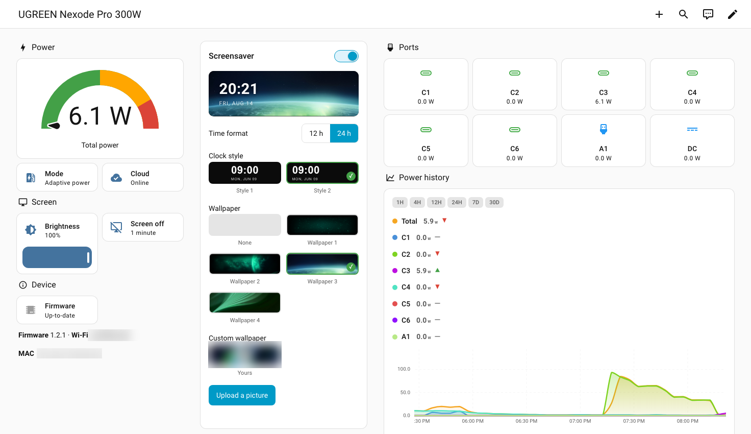

The screensaver card
The charger’s display is 560×170, and the app has a whole panel for it. The
integration ships a card that does the same job, so you do not have to reach for
the phone to change the clock or the picture.
The strip at the top is a live preview of what the charger will actually show.
Upload a picture opens a crop window over your own photo — drag, zoom and
rotate — because at 3.3:1 a photo almost never suits the screen as taken.
The card is served by the integration itself, so there is no second HACS entry
and no Lovelace resource to register. One line of YAML:

There is also a ready-made dashboard in the repo (docs/dashboard.yaml) — the
one in the screenshot, which fits a laptop screen without scrolling. One heads
up on it: the power-history card is statistics-graph-chart-card from HACS. If
you do not have that, only that card errors and the rest is fine — delete it, or
swap in the built-in history-graph with the same entities.
