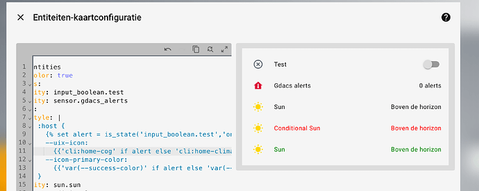

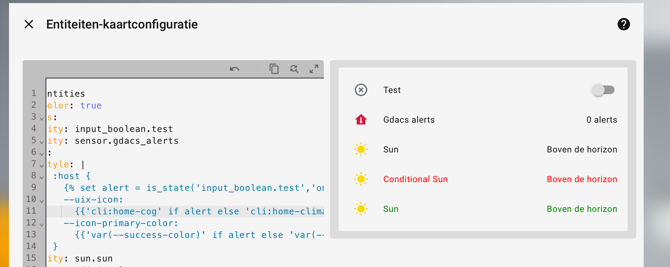

no Uix supports custom icons alright . Id say it is agnostic to that, and just uses the icon picker in Ha

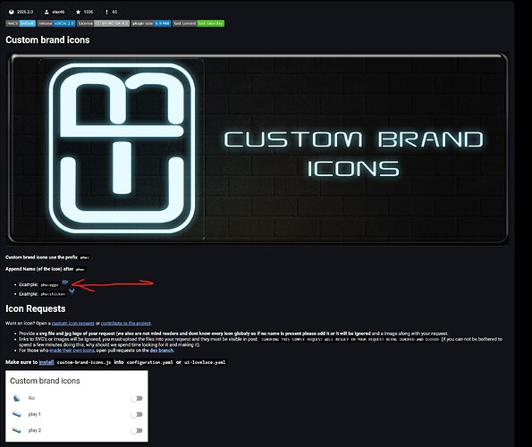

I dont use PHU, but could be that resource has a hard coded dependency to card-mod?
or its just your cache acting up, although that should really not be happening.
you’re sure uix is loaded correctly and showing in the Inspector console?:

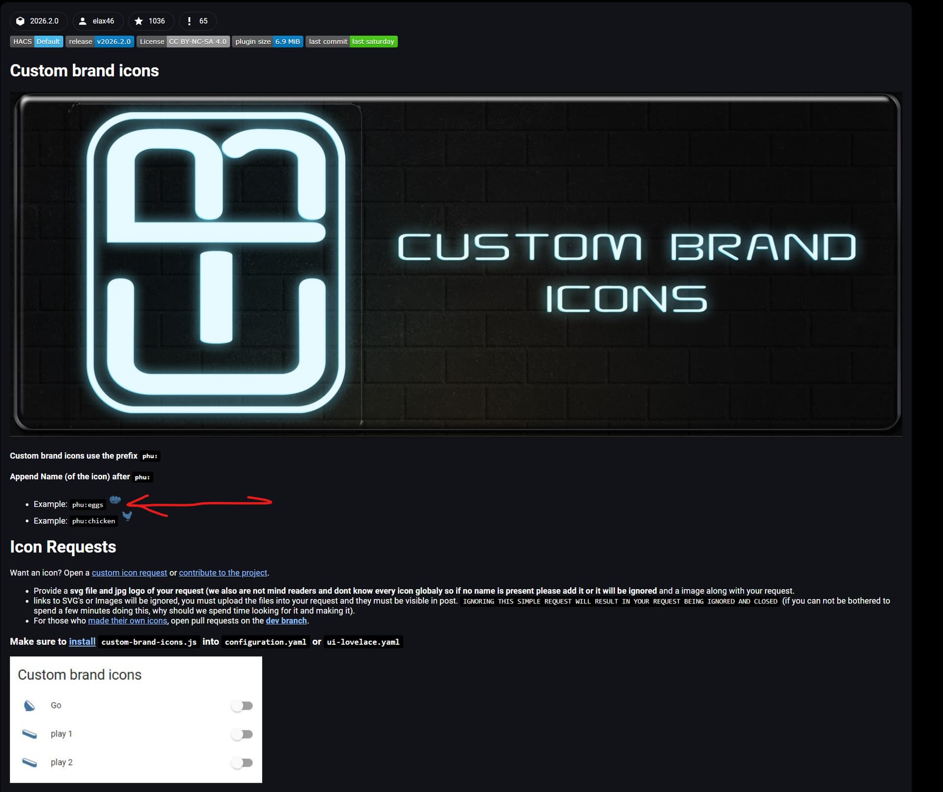

PHU is part of the custom brand icons, installed from HACS. I will play with them a little bit more, when be back home.

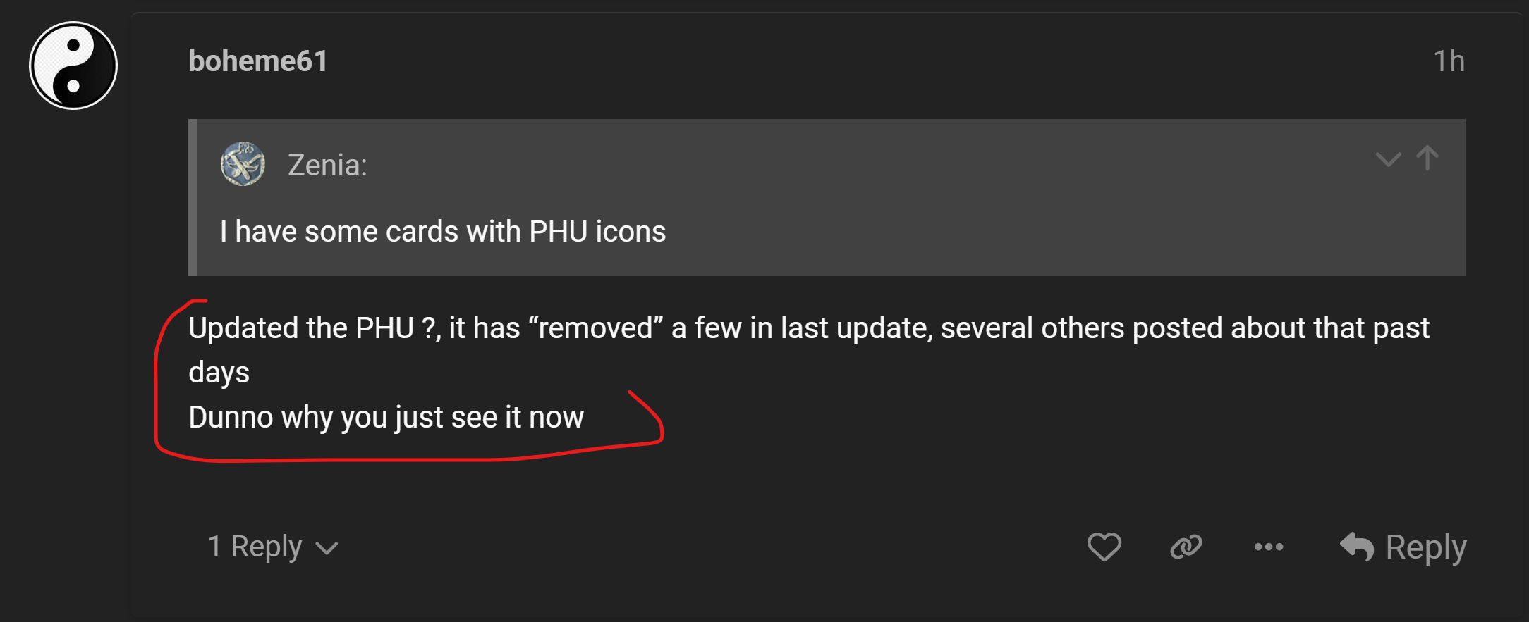

Updated the PHU ?, it has ā€œremovedā€ a few in last update, several others posted about that past days
Dunno why you just see it now

Hmm. I still have these icons in my dashboards, and they were working fine until I now ( card_mod to uix ) Thank you for update, I will check all my dashboards and replace PHU to IOS or something else

Thank you , but really not a big deal. It’s a lot of great and nice looking icons for dashboards in HA ( thanks to all developers). I already changed phu icons in my main dashboard to ios.
ha, nice. good you could switch.
however, I am sure Dev wants to get to the bottom of that…
I see, icons where removed, so no issue, a feature :wink:
