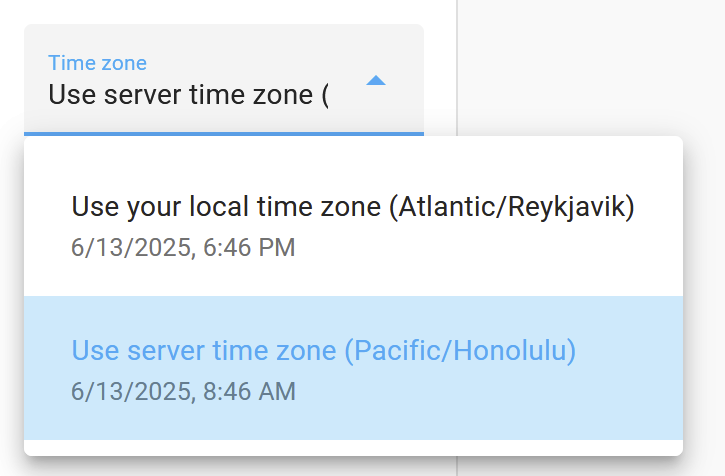

My HA instance thinks I’m in a different timezone based on some signal from my browser (Librewolf) and I can’t for the life of me figure out how to reset it – the symptom is that all of my times are showing up incorrectly, even though I’ve selected to use server time in my config.
I’m in Pacific/Honolulu, which is where my server resides. However, the UI is picking up something from the browser that thinks I’m in Rekyjavik (I did travel through there recently), but my PC time is correctly set. Other browsers don’t have this issue. I tried clearing cookies and cache with no luck. Any idea how I might reset this?
