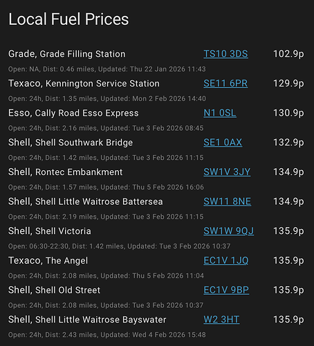

UK Fuel Finder - Home Assistant Sensor
Fetch nearby petrol station prices from the UK Government’s Fuel Finder API.
Features
  • Automatic OAuth token management with refresh
  • Finds stations within configurable radius
  • Incremental price updates (only fetches changes since last run)
  • Shows cheapest E10 and B7 diesel nearby
  • Station details including opening hours, distance, postcode
  • Runs as Home Assistant command_line sensor
  • Use --refresh-stations to force a stations refresh.
  • Supports overriding config via --config (JSON) and/or command-line flags.
Requirements
  • UK Government Fuel Finder API credentials (Sign up here)
  • Python 3.7+
Installation
  1. Get API Credentials
  2. Install the Script
    Copy uk_fuel_finder.py to your Home Assistant config directory or scripts directory (/config/scripts or /config/python or wherever you choose)
  3. Configure the Script
    Edit uk_fuel_finder.py and update the CONFIG section:
    DEFAULT_CONFIG = {
     "client_id": "YOUR_CLIENT_ID",
     "client_secret": "YOURCLIENT_SECRET",
     "home_lat": YOUR_LAT,
     "home_lon": YOUR_LON,
     "radius_miles": 10,
     "token_file": "/config/.storage/uk_fuel_finder/token.json",
     "state_file": "/config/.storage/uk_fuel_finder/state.json",
  4. Add to Home Assistant
    Add to configuration.yaml:
    command_line:
      - sensor:
          command: "python3 /config/scripts/fuel_finder.py"
          scan_interval: 10800  # 3 hours
          value_template: "{{ value_json.state }}"
          json_attributes:
            - icon
            - best_e10
            - best_b7
            - stations
            - last_update
  5. Restart Home Assistant
Usage
The sensor provides:
  • State: Number of nearby stations with prices
  • Attributes:
    • best_e10: Cheapest E10 station (name, price, miles)
    • best_b7: Cheapest B7 diesel station (name, price, miles)
    • stations: Array of all nearby stations sorted by distance
    • last_update: Timestamp of last update
Station Data Structure
Each station in the stations array contains:
  "id": "station_id",
  "name": "Station Name",
  "postcode": "AB12 3CD",
  "miles": 2.3,
  "open_today": "06:00-22:00",
  "e10_price": 142.9,
  "e10_updated": "2025-02-03T10:30:00Z",
  "b7_price": 149.9,
  "b7_updated": "2025-02-03T10:30:00Z"
Prices are in pence per litre (e.g., 142.9 = £1.429/litre).

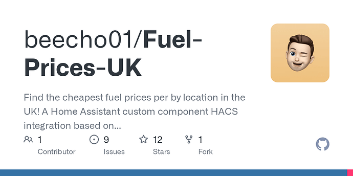

There is one already:
Cool, @Holdestmade was just looking for an integration after I got @Rozak node Red working.
The integration from beecho01 is using the old data feeds that are limited to specific companies rather than the new Fuel Finder API that will include every fuel retailer
Excellent! I did it as a script in python as it just ran in the background and updated a fairly simple command_line sensor - but top job on the integration! Love it!!!
The beecho01 version uses the old data sources so thats why I wrote the python version.
I’ve added a few more pops, bells and whistles to the python script in the meantime - now it will:

And this markdown card to display prices:
  - type: markdown
    title: Local Fuel Prices
    content: >-
      {%- if states('sensor.local_petrol_prices') | int | default(0, true) >= 1
        <center>
        <table width="100%">
        {%- for station in
             state_attr('sensor.local_petrol_prices', 'stations')
             | selectattr('e10_price', 'defined')
             | sort(attribute='e10_price')
          <tr>
            <td>{{ station.brand.split(' ')[0] | title }}, <font size=2>{{ station.name | title }}</font></td>
            <td><a href="https://waze.com/ul?ll={{ station.lat }}%2C{{ station.lon }}&navigate=yes&zoom=17">{{ station.postcode | upper }}</a></td>
            <td align="right">{{ station.e10_price }}p</td>
          </tr>
          <tr>
            <td colspan="3"><font size=1 color="grey">Open: {{ iif(station.open_today is not none, station.open_today, "NA") }}, Dist: {{ station.distance_miles }} miles, Updated: {{ station.e10_updated | as_timestamp | timestamp_custom('%a %-d %b %Y %H:%M', true, 0)}}</font></td>
          </tr>
        {%- endfor -%}
        </table>
        </center>
        <p><font size=1 color="grey">Updated: {{ state_attr('sensor.local_petrol_prices', 'last_update') | as_timestamp | timestamp_custom('%a %-d %b %Y %H:%M', true, 0)}}</font></p>
      {%- else -%}
        <center>No Fuel Prices Available</center>
      {%- endif -%}
    card_mod:
      style:
        ha-markdown $:
          ha-markdown-element: |
            td {
              border: none !important;
              padding: 0px !important;
… form which you get something like (where the postcodes are active links to Waze to direct you to the station - just for fun):
