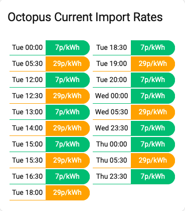

Here is my current plan using Dave’s other contribution of a well presented rate card
Thanks. Unfortunately Ohme does the deciding itself and informs Octopus at some point later (I believe), so the Octopus integration doesn’t help for this setup - or at least how mine is currently set up.
I used to be able to do this when I first had just a 3pin plug charger, but when the Ohme was installed then the rates now only change during the fixed overnight period and not at points during the day.
I believe to is to do with ‘who’ is making the decision on when to charge. For most chargers Octopus is doing that, but for Ohme they have their own algorithm.
