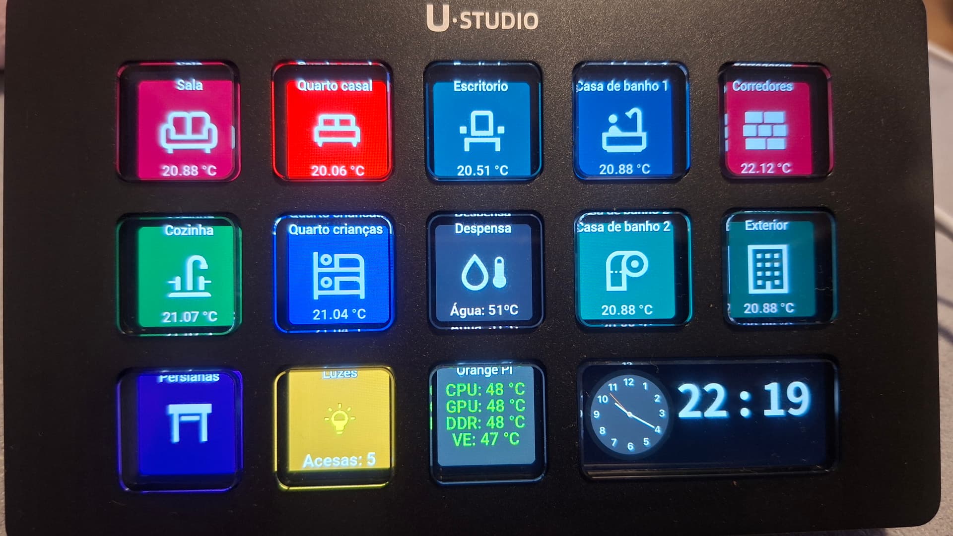

I managed to add support for Material You color. You’ll only have to provide the base color with material_you_color, and then select which color role you want in icon_color, icon_background_color, icon_border_color or text_color.

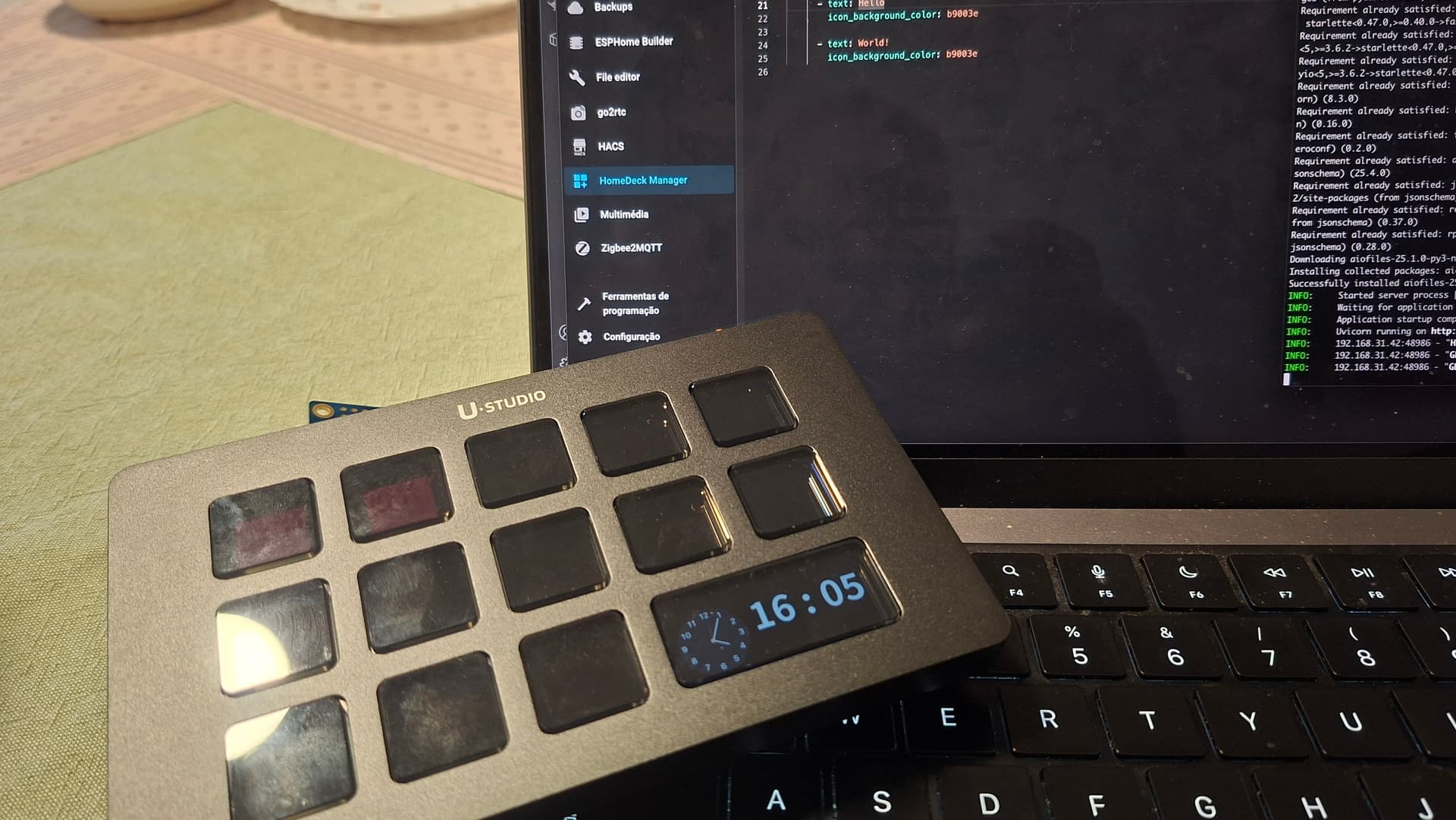

I’ve installed your Homedeck app onto a Pi, and the add-on onto HA - which can see the Pi homedeck server (can see & edit the configuration file). But I only get the default buttons on the D200 (i.e. the ones displayed when you power it up without connecting it to anything) rather than anything server up via Homedeck. What am I missing/doing wrong?
